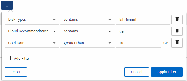

  5. Click the filter icon, add the following three filters, and then click Apply Filter:
    • Disk Type contains FabricPool
    • Cloud Recommendation contains tier
    • Cold Data greater than 10 GB A UI screenshot that shows how you can add and apply filter.

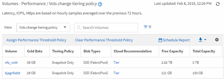

  6. Click the top of the Cold Data column so that the volumes with the most cold data appear at the top of the view.
  7. Save the view with a name to reflect what the view is showing, for example “Vols change tiering policy”.A UI screenshot that shows Vols change tiering policy page with the required columns in the correct order.
