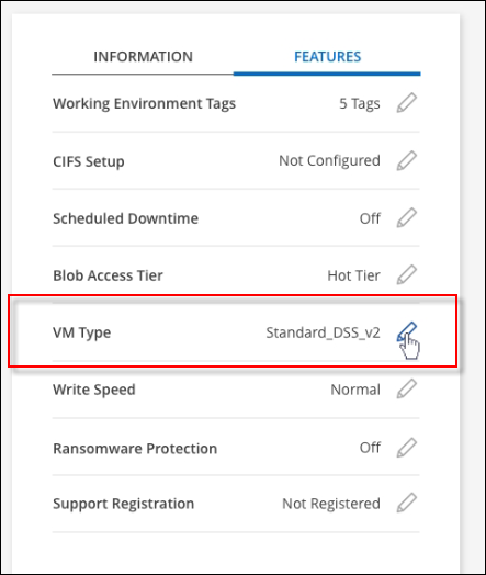

  1. On the Systems page, select the system.
  2. On the Overview tab, click the Features panel and then click the pencil icon next to VM type.
    If you are using a node-based pay-as-you-go (PAYGO) license, you can optionally choose a different license and VM type by clicking the pencil icon next to License type.
  3. Select a VM type, select the check box to confirm that you understand the implications of the change, and then click Change.
