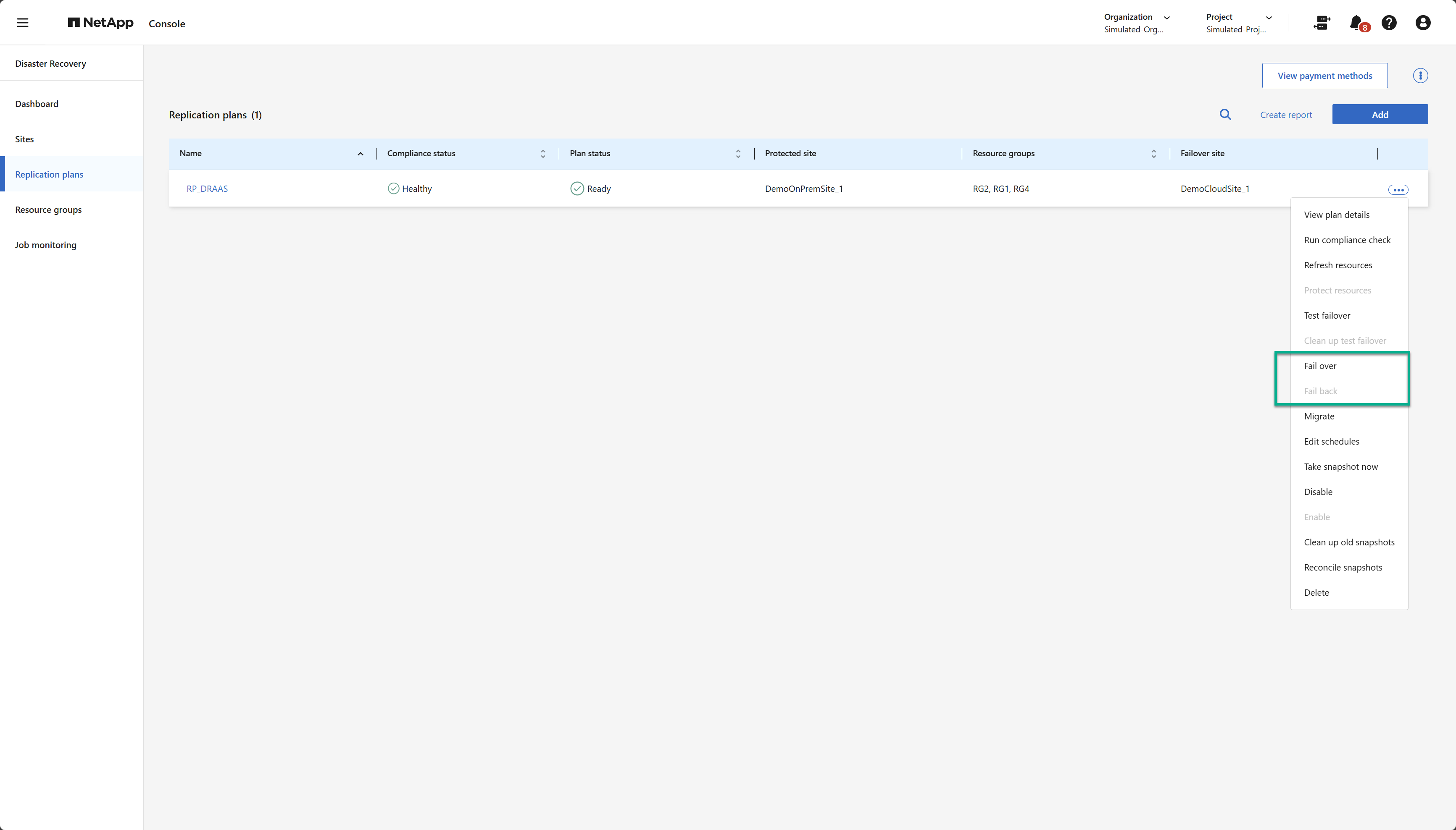

Steps to perform a failover
  1. From the Replication plans page, select the replication plan's Actions option Horizontal dots for Actions menu.
  2. Select Fail over.
    Failover menu option
  3. If the production (protected) site is not accessible, select a previously created snapshot as your recovery image. To do this, select Select.
  4. Select the backup to be used for the recovery.
  5. (Optional) Select whether you want BlueXP disaster recovery to force the failover process regardless of the state of the replication plan. This should only be done as a last resort.
  6. (Optional) Select whether you want BlueXP disaster recovery to automatically create a reverse protection relationship after the production site has been recovered.
  7. Type the word “Failover” to verify that you would like to proceed.
  8. Select Failover.
    Failover dialog box

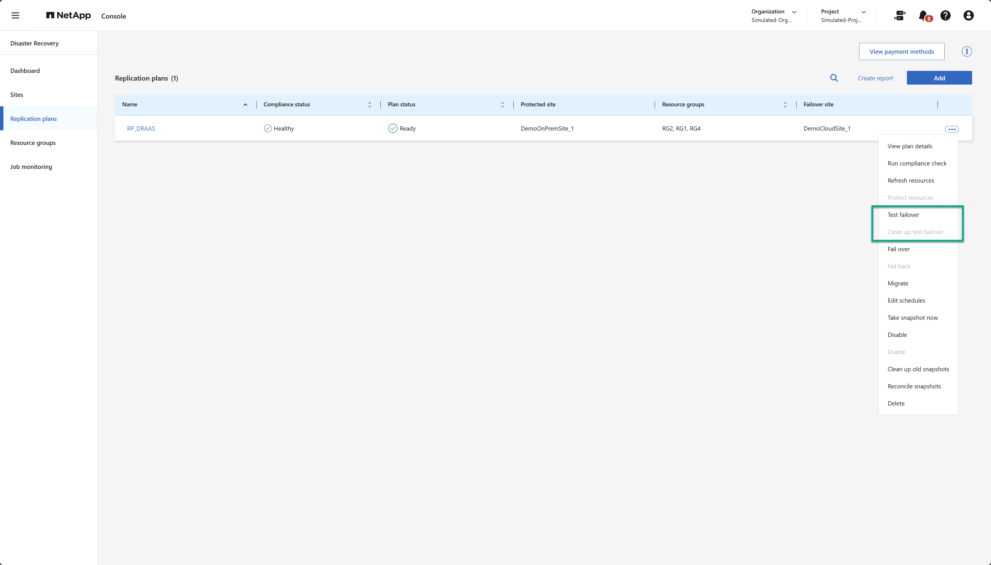

Test failover
A test failover is similar to a failover except for two differences.
  • The production site is still active and all VMs are still operating as expected.
  • BlueXP disaster recovery protection of the production VMs continues.
This is accomplished by using native ONTAP FlexClone volumes at the destination site. To learn more about test failover, see Fail over applications to a remote site | NetApp Documentation.
The steps for executing a test failover are identical to those used to execute a real failover except that you use the Test failover operation on the replication plan's context menu.

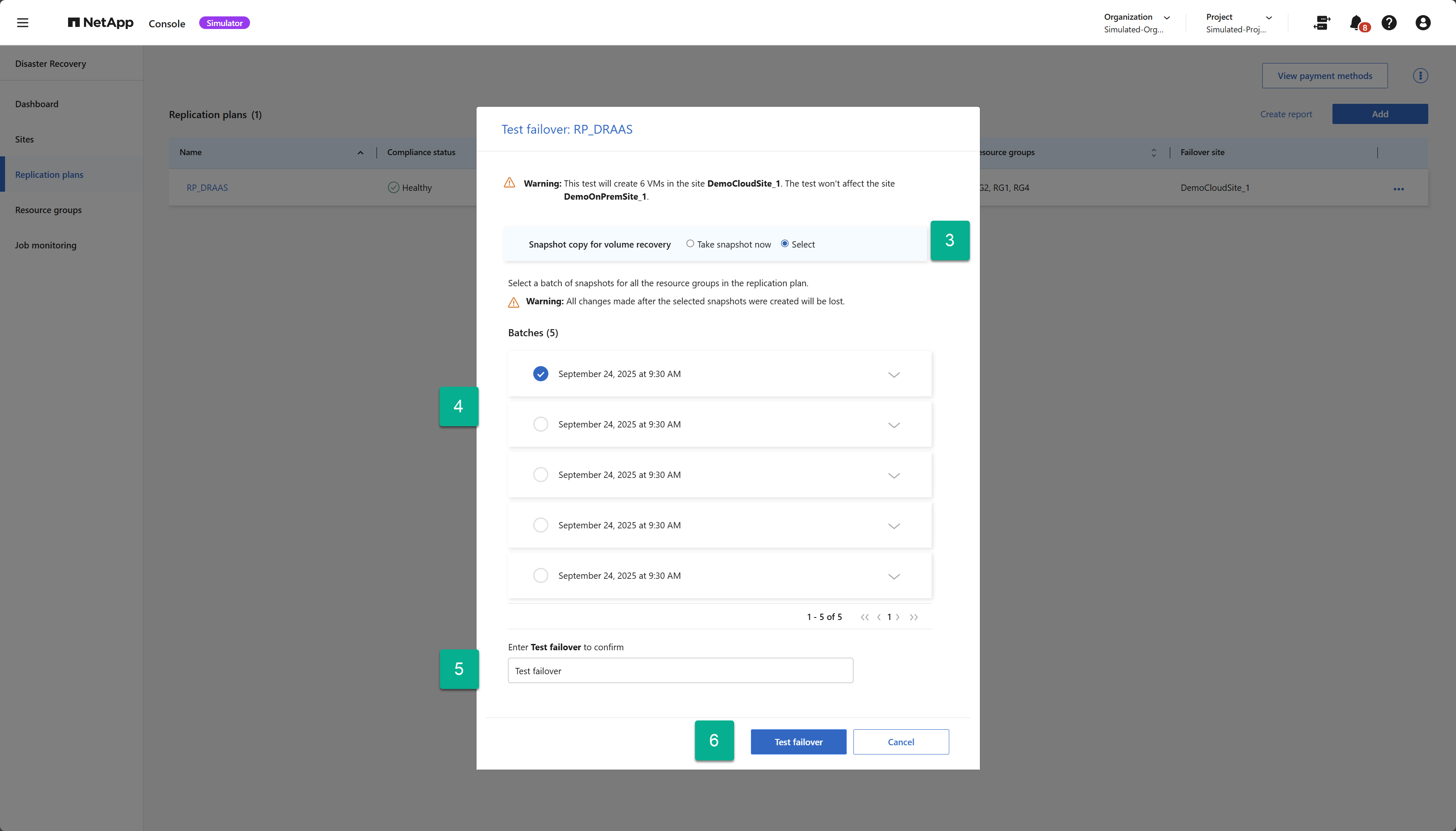

Steps
  1. Select the replication plan's Actions option Horizontal dots for Actions menu.
  2. Select Test failover from the menu.
    Test failover menu option
  3. Decide if you want get the latest state of the production environment (Take snapshot now) or use a previously created replication plan backup (Select)
  4. If you chose a previously created backup, then select the backup to be used for the recovery.
  5. Type the word “Test failover” to verify that you would like to proceed.
  6. Select Test failover.
    Test failover dialog box

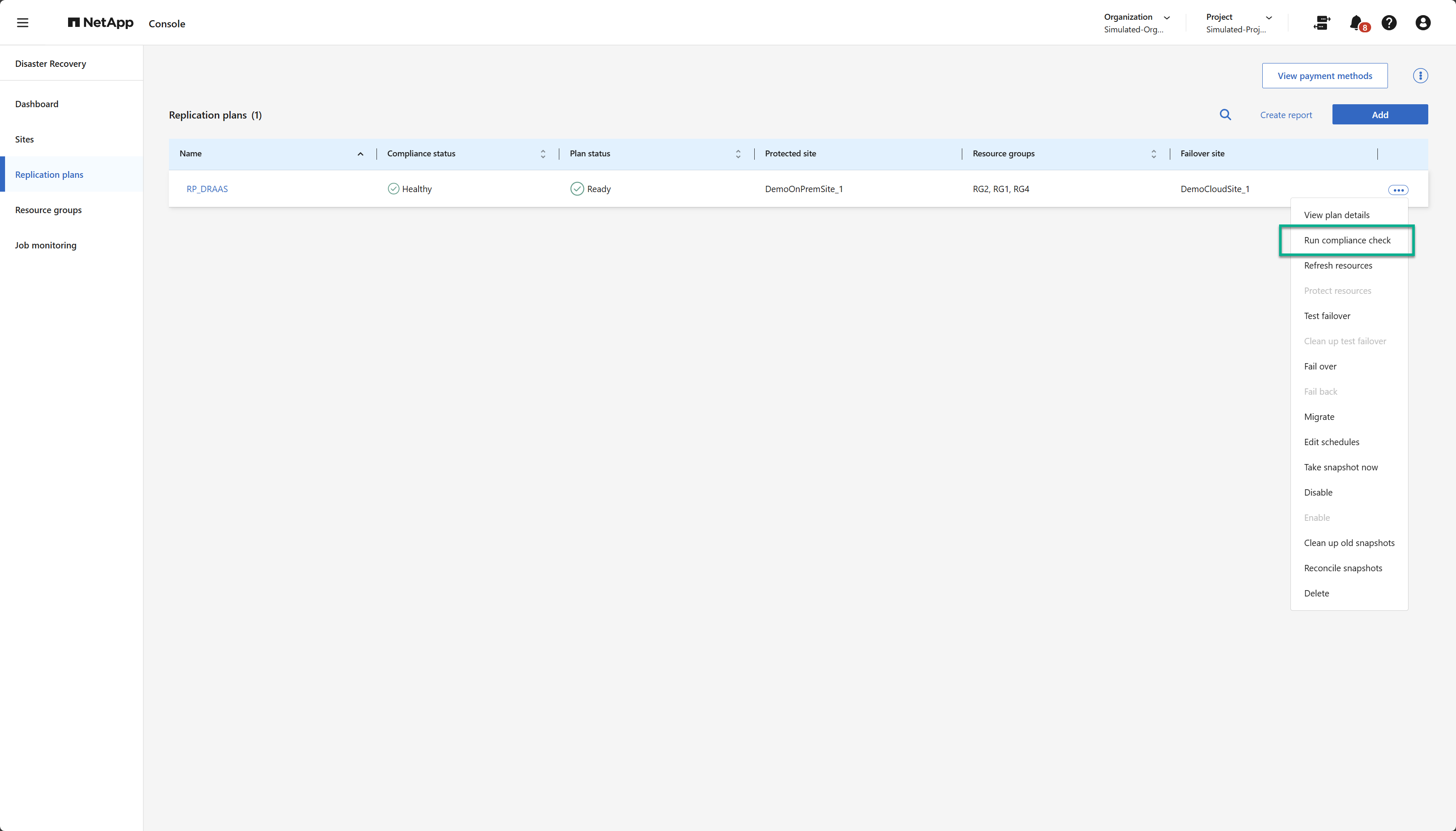

Run a compliance check
Compliance checks are run every three hours, by default. At any time, you might want to manually run a compliance check.
Steps
  1. Select the Actions option Actions menu icon in BlueXP disaster recovery service next to the replication plan.
  2. Select the Run compliance check option from the replication plan's Actions menu:
    Run compliance check menu option
  3. To change how often BlueXP disaster recovery automatically runs compliance checks, select Edit schedules option from the replication plan's Actions menu.

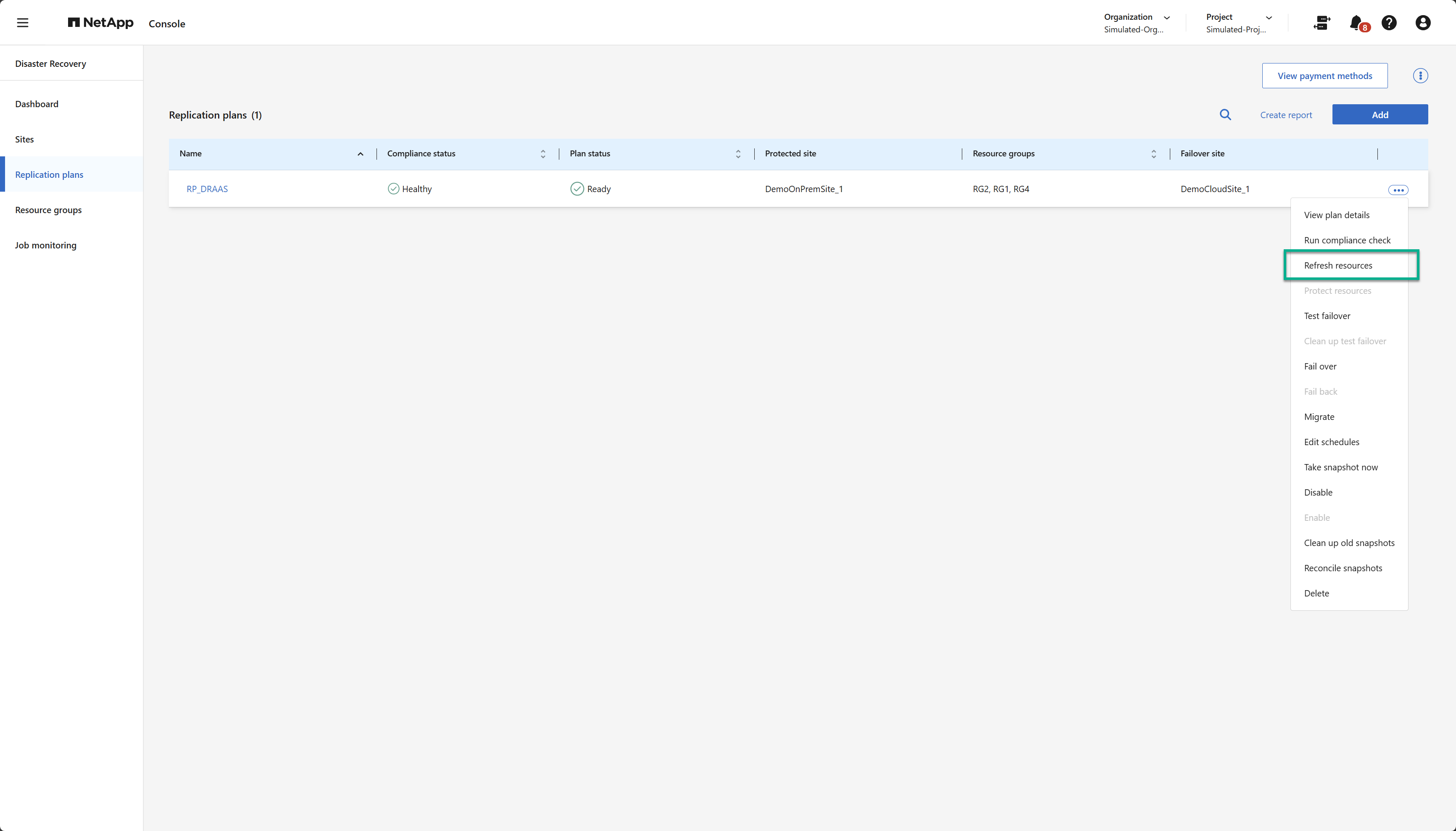

Refresh resources
Any time you make changes to your virtual infrastructure — such as adding or deleting VMs, adding or deleting datastores, or moving VMs between datastores — you need to perform a refresh of the impacted vCenter clusters in BlueXP disaster recovery service. The service does this automatically once every 24 hours by default, but a manual refresh ensures that the latest virtual infrastructure information is available and taken into account for DR protection.
There are two instances where a refresh is necessary:
  • vCenter refresh: Perform a vCenter refresh anytime VMs are added or deleted from or moved out of a vCenter cluster:
  • Replication plan refresh: Perform a replication plan refresh anytime a VM is moved between datastores in the same source vCenter cluster.
Refresh resources menu option

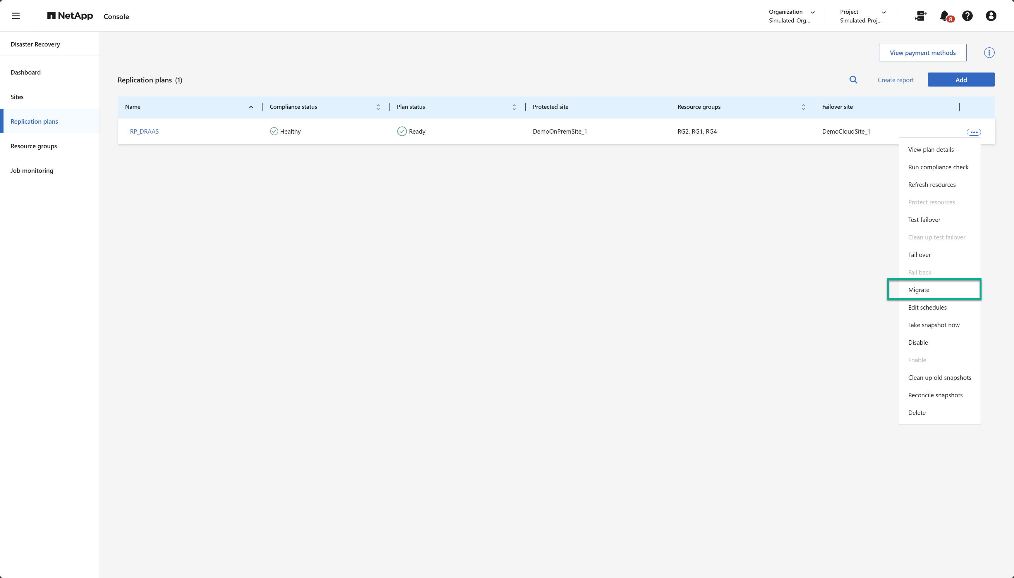

Migrate
While BlueXP disaster recovery is primarily used for disaster recovery use cases, it can also enable one-time moves of a set of VMs from the source site to the destination site. This could be for a concerted migration to cloud project or it could be used for disaster avoidance — such as bad weather, political strife, or other potential temporary catastrophic events.
  2. To move the VMs in a replication plan to the destination Amazon EVS cluster, select Migrate from the replication plan's Actions menu:
    Migrate menu option
  3. Enter information in the Migrate dialog box.

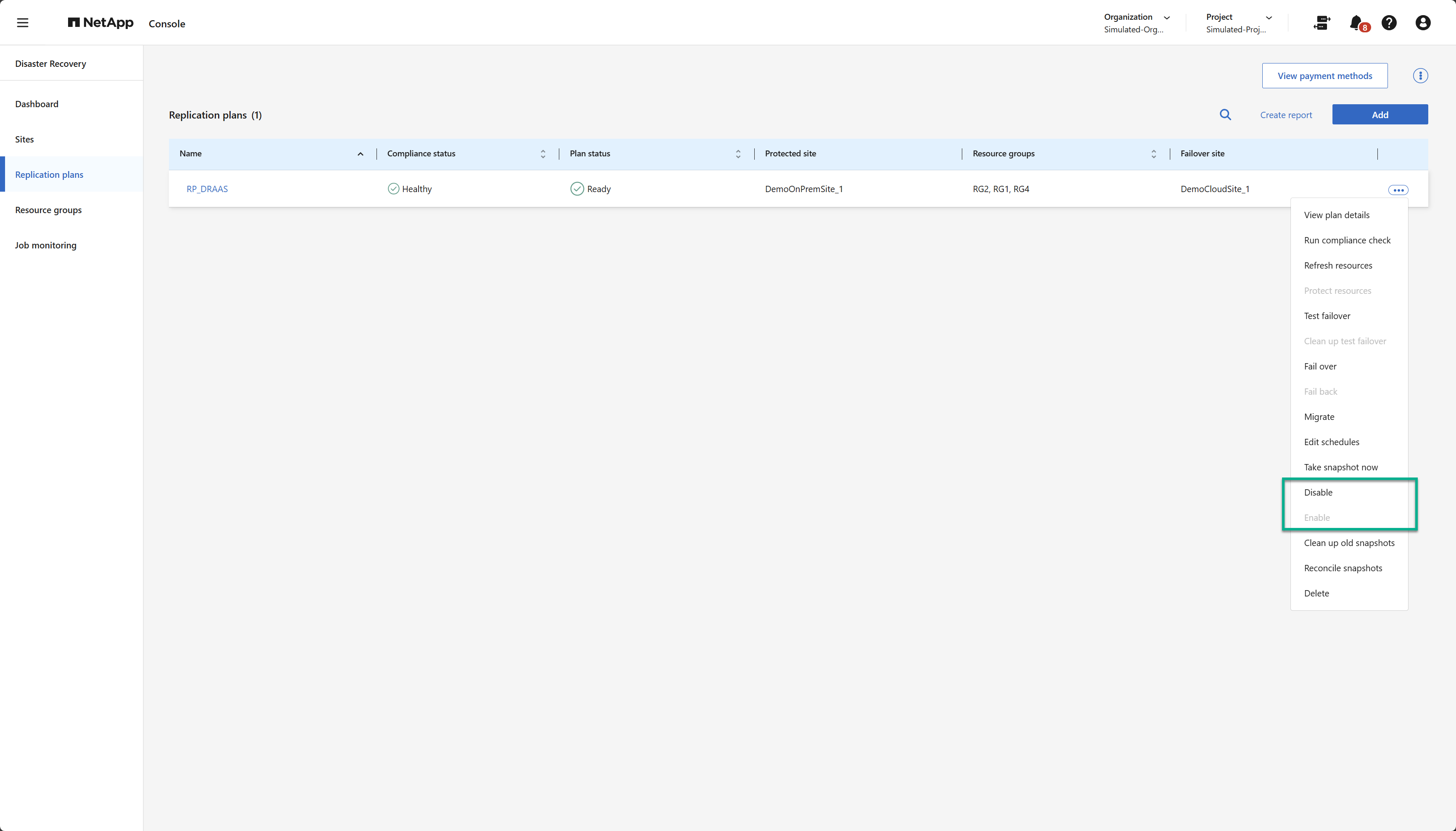

Disable or enable replication plan
You might need to temporarily stop the replication plan to perform some operation or maintenance that could impact the replication process. The service provides a method to stop and start replication.
  1. To temporarily stop replication, select Disable on the replication plan's Actions menu.
  2. To restart replication, select Enable on the replication plan's Actions menu.
    When the replication plan is active, the Enable command is grayed out. When the replication plan is disabled, the Disable command is grayed out.
    Disable/Enable menu option

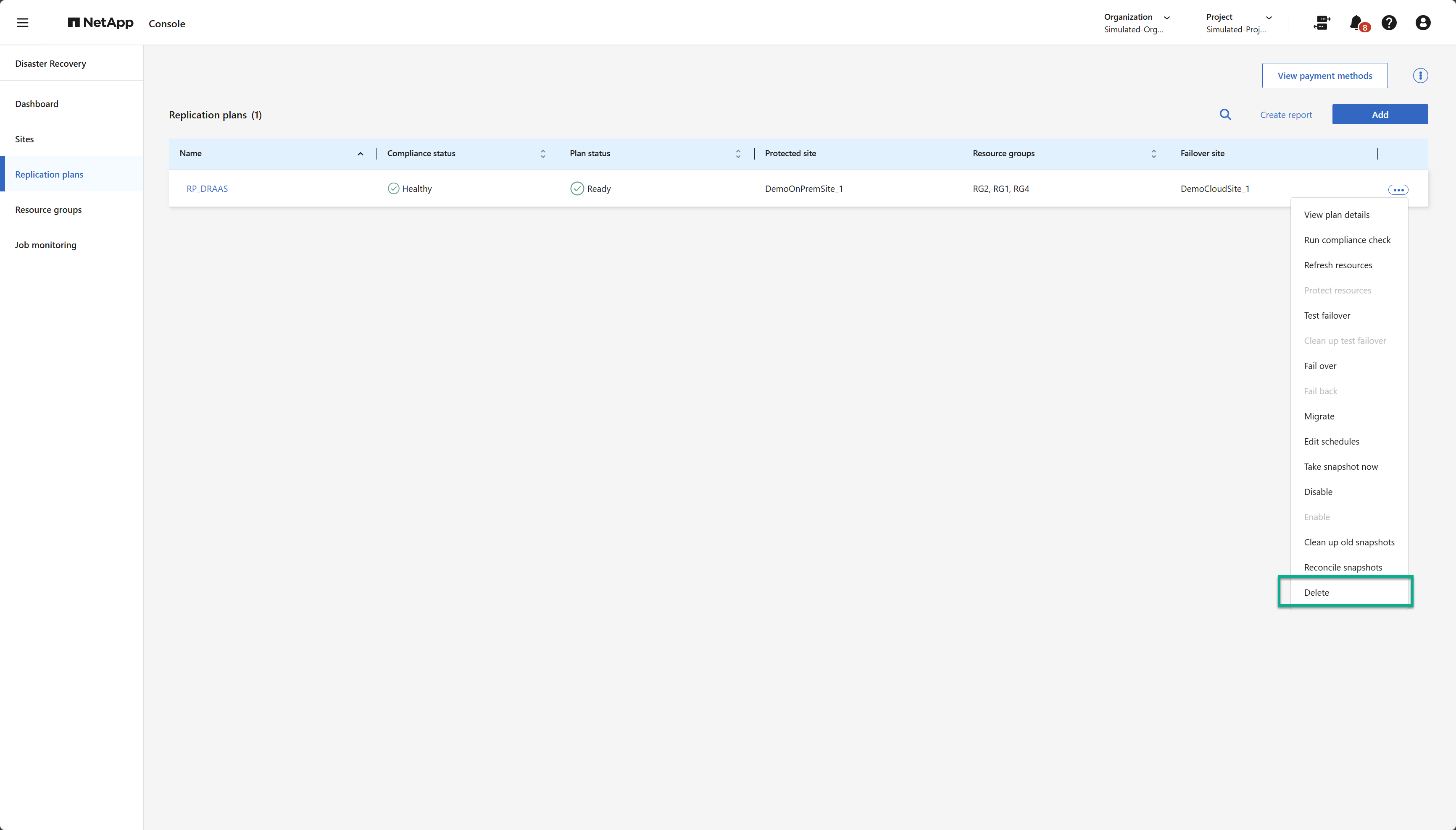

Delete replication plan
If the replication plan is no longer needed, you can delete it.
  2. To delete the replication plan, select Delete from the replication plan's context menu.
    Delete menu option
