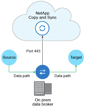

Data broker on your premises
The following image shows the data broker running on-premises in a data center. Again, the source and target can be in any location, as long as there's a connection to the data broker.
A diagram that shows Copy and Sync, the data broker running on-premises, and connections to the source and target.
