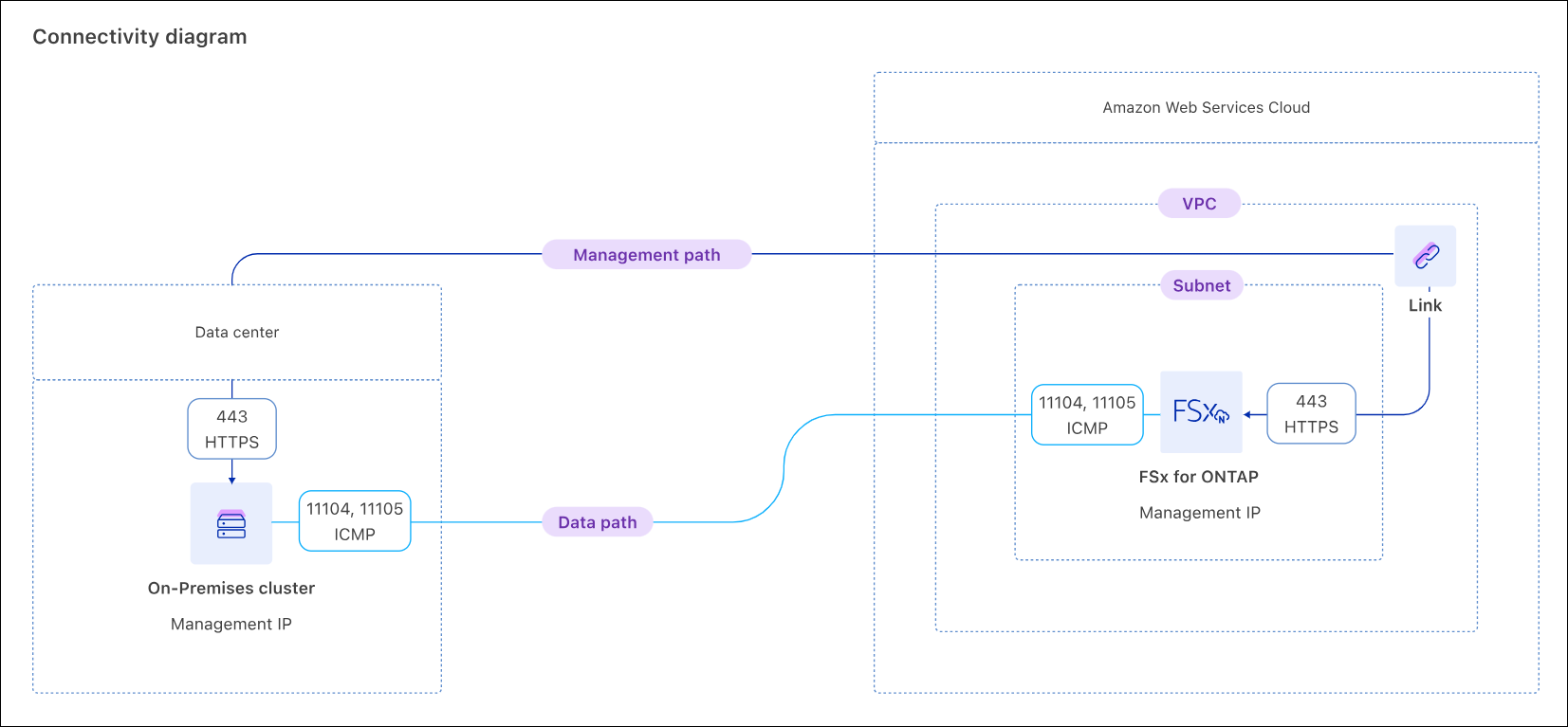

  • Connectivity as shown in the following diagram.
    Screenshot that shows how an on-premises ONTAP cluster should be connected for the management path and data path to Amazon Web Services Cloud
