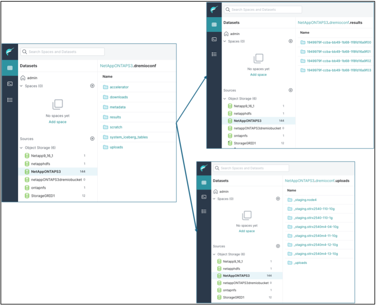

  9. The Dremio configuration is stored in NetApp object storage. In our validation, the "dremioconf" bucket resides in an ontap S3 bucket. The below picture shows some details from "scratch" and "uploads" folder of the "dremioconf" S3 bucket.
Figure showing dremio with NetApp object storage

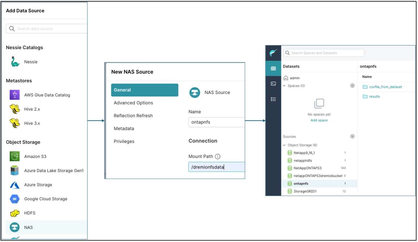

  2. Configure NAS ( specifically NFS ) as a source in Dremio.
    1. Dremio dashboard → datasets → sources → add source.
    2. In the general section, enter the name and NFS mount path. Please make sure the NFS mount path is mounted on the same folder on all the nodes in the Dremio cluster.
Figure showing list of files from  NetApp object storage
