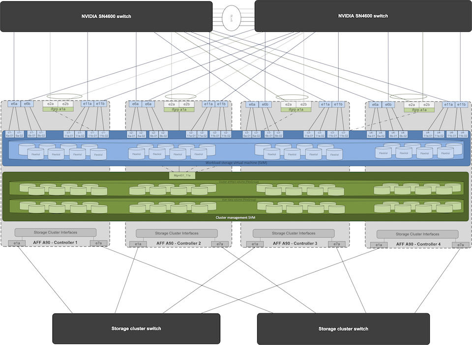

Storage system configuration
This section describes key details for configuration of the A90 storage system for this solution. For more details about configuration of ONTAP systems please refer to the ONTAP documentation. The diagram below shows the logical configuration of the storage system.
NetApp A90 storage cluster logical configuration
Figure showing input/output dialog or representing written content
The basic steps used to configure the storage system are outlined below. This process assumes that basic storage cluster installation has been completed.
  1. Configure 1 aggregate on each controller with all available partitions minus 1 spare
    • aggr create -node <node> -aggregate <node>_data01 -diskcount <47>
  2. Configure ifgrps on each controller
    • net port ifgrp create -node <node> -ifgrp a1a -mode multimode_lacp -distr-function port
    • net port ifgrp add-port -node <node> -ifgrp <ifgrp> -ports <node>:e2a,<node>:e2b
  3. Configure mgmt vlan port on ifgrp on each controller
    • net port vlan create -node aff-a90-01 -port a1a -vlan-id 31
    • net port vlan create -node aff-a90-02 -port a1a -vlan-id 31
    • net port vlan create -node aff-a90-03 -port a1a -vlan-id 31
    • net port vlan create -node aff-a90-04 -port a1a -vlan-id 31
  4. Create broadcast domains
    • broadcast-domain create -broadcast-domain vlan21 -mtu 9000 -ports aff-a90-01:e6a,aff-a90-01:e11a,aff-a90-02:e6a,aff-a90-02:e11a,aff-a90-03:e6a,aff-a90-03:e11a,aff-a90-04:e6a,aff-a90-04:e11a
    • broadcast-domain create -broadcast-domain vlan22 -mtu 9000 -ports aaff-a90-01:e6b,aff-a90-01:e11b,aff-a90-02:e6b,aff-a90-02:e11b,aff-a90-03:e6b,aff-a90-03:e11b,aff-a90-04:e6b,aff-a90-04:e11b
    • broadcast-domain create -broadcast-domain vlan31 -mtu 9000 -ports aff-a90-01:a1a-31,aff-a90-02:a1a-31,aff-a90-03:a1a-31,aff-a90-04:a1a-31
  5. Create management SVM
  6. Configure management SVM
    • create LIF
      • net int create -vserver basepod-mgmt -lif vlan31-01 -home-node aff-a90-01 -home-port a1a-31 -address 192.168.31.X -netmask 255.255.255.0
    • create FlexGroup volumes-
      • vol create -vserver basepod-mgmt -volume home -size 10T -auto-provision-as flexgroup -junction-path /home
      • vol create -vserver basepod-mgmt -volume cm -size 10T -auto-provision-as flexgroup -junction-path /cm
    • create export policy
      • export-policy rule create -vserver basepod-mgmt -policy default -client-match 192.168.31.0/24 -rorule sys -rwrule sys -superuser sys
  7. Create data SVM
  8. Configure data SVM
    • configure SVM for RDMA support
      • vserver nfs modify -vserver basepod-data -rdma enabled
    • create LIFs
      • net int create -vserver basepod-data -lif c1-6a-lif1 -home-node aff-a90-01 -home-port e6a -address 100.127.102.101 -netmask 255.255.255.0
      • net int create -vserver basepod-data -lif c1-6a-lif2 -home-node aff-a90-01 -home-port e6a -address 100.127.102.102 -netmask 255.255.255.0
      • net int create -vserver basepod-data -lif c1-6b-lif1 -home-node aff-a90-01 -home-port e6b -address 100.127.202.101 -netmask 255.255.255.0
      • net int create -vserver basepod-data -lif c1-6b-lif2 -home-node aff-a90-01 -home-port e6b -address 100.127.202.102 -netmask 255.255.255.0
      • net int create -vserver basepod-data -lif c1-11a-lif1 -home-node aff-a90-01 -home-port e11a -address 100.127.102.103 -netmask 255.255.255.0
      • net int create -vserver basepod-data -lif c1-11a-lif2 -home-node aff-a90-01 -home-port e11a -address 100.127.102.104 -netmask 255.255.255.0
      • net int create -vserver basepod-data -lif c1-11b-lif1 -home-node aff-a90-01 -home-port e11b -address 100.127.202.103 -netmask 255.255.255.0
      • net int create -vserver basepod-data -lif c1-11b-lif2 -home-node aff-a90-01 -home-port e11b -address 100.127.202.104 -netmask 255.255.255.0
      • net int create -vserver basepod-data -lif c2-6a-lif1 -home-node aff-a90-02 -home-port e6a -address 100.127.102.105 -netmask 255.255.255.0
      • net int create -vserver basepod-data -lif c2-6a-lif2 -home-node aff-a90-02 -home-port e6a -address 100.127.102.106 -netmask 255.255.255.0
      • net int create -vserver basepod-data -lif c2-6b-lif1 -home-node aff-a90-02 -home-port e6b -address 100.127.202.105 -netmask 255.255.255.0
      • net int create -vserver basepod-data -lif c2-6b-lif2 -home-node aff-a90-02 -home-port e6b -address 100.127.202.106 -netmask 255.255.255.0
      • net int create -vserver basepod-data -lif c2-11a-lif1 -home-node aff-a90-02 -home-port e11a -address 100.127.102.107 -netmask 255.255.255.0
      • net int create -vserver basepod-data -lif c2-11a-lif2 -home-node aff-a90-02 -home-port e11a -address 100.127.102.108 -netmask 255.255.255.0
      • net int create -vserver basepod-data -lif c2-11b-lif1 -home-node aff-a90-02 -home-port e11b -address 100.127.202.107 -netmask 255.255.255.0
      • net int create -vserver basepod-data -lif c2-11b-lif2 -home-node aff-a90-02 -home-port e11b -address 100.127.202.108 -netmask 255.255.255.0
  9. Configure LIFs for RDMA access
    • For deployments with ONTAP 9.15.1, RoCE QoS configuration for physical information requires os-level commands that are not available in the ONTAP CLI. Please contact NetApp Support for assistance with configuration of ports for RoCE support. NFS over RDMA functions without issue
    • Beginning with ONTAP 9.16.1, physical interfaces will automatically be configured with appropriate settings for end-to-end RoCE support.
    • net int modify -vserver basepod-data -lif * -rdma-protocols roce
  10. Configure NFS parameters on the data SVM
    • nfs modify -vserver basepod-data -v4.1 enabled -v4.1-pnfs enabled -v4.1-trunking enabled -tcp-max-transfer-size 262144
  11. Create FlexGroup volumes-
    • vol create -vserver basepod-data -volume data -size 100T -auto-provision-as flexgroup -junction-path /data
  12. Create export policy
    • export-policy rule create -vserver basepod-data -policy default -client-match 100.127.101.0/24 -rorule sys -rwrule sys -superuser sys
    • export-policy rule create -vserver basepod-data -policy default -client-match 100.127.201.0/24 -rorule sys -rwrule sys -superuser sys
  13. create routes
    • route add -vserver basepod_data -destination 100.127.0.0/17 -gateway 100.127.102.1 metric 20
    • route add -vserver basepod_data -destination 100.127.0.0/17 -gateway 100.127.202.1 metric 30
    • route add -vserver basepod_data -destination 100.127.128.0/17 -gateway 100.127.202.1 metric 20
    • route add -vserver basepod_data -destination 100.127.128.0/17 -gateway 100.127.102.1 metric 30
