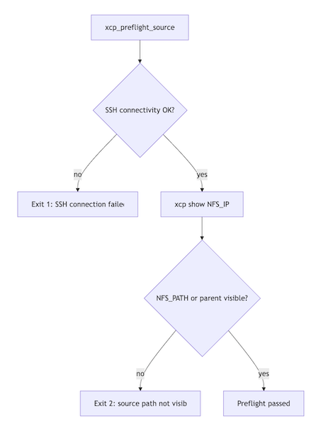

6.2 XCP Preflight Validation Flow
The preflight task runs before an XCP copy. It verifies that Airflow can reach the XCP host through SSH and that the configured ONTAP NAS NFS source path is visible to XCP. The explicit exit conditions stop the pipeline before a copy begins when connectivity or source visibility is incorrect.

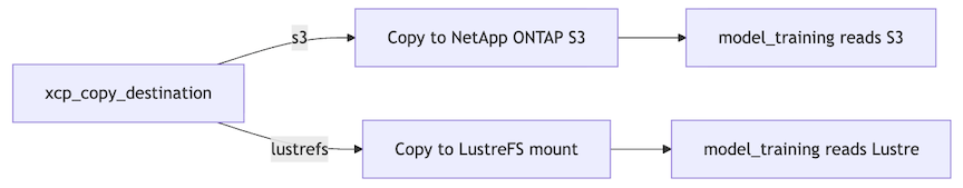

6.5 XCP Destination Decision Flow
This decision diagram shows how one runtime parameter determines the copy target and the training read path. Select s3 for the ONTAP S3 object destination or lustrefs for the parallel filesystem destination. Downstream stages use the matching source automatically, avoiding changes to model code when storage placement changes.
6.6 XCP Failure Handling and Guardrails
These guardrails make configuration and infrastructure failures observable at the earliest practical point. Preflight failures prevent an invalid transfer, filesystem-type checks validate the ONTAP NAS and LustreFS mounts, and S3 credential validation applies only when ONTAP S3 is the selected XCP destination.
Condition Guard Behavior
Unsupported xcp_copy_destination value
Pipeline rejects the value before any data movement
LustreFS mount not present
Filesystem-type validation fails; copy halted before data movement
SSH unreachable
Preflight exits with code 1 before any copy
NFS path not visible
Preflight exits with code 2 before any copy
