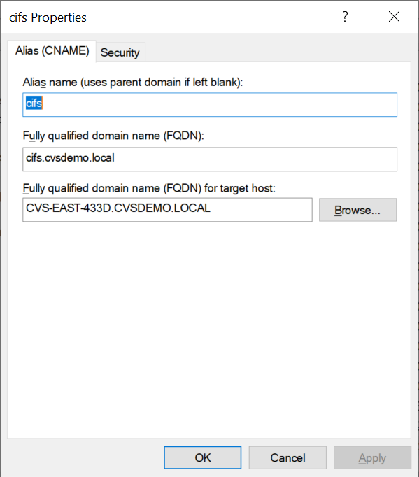

Using SMB name aliases
In some cases, it might be a security concern for end users to know the machine account name in use for Google Cloud NetApp Volumes. In other cases, you might simply want to provide a simpler access path to your end users. In those cases, you can create SMB aliases.
If you want to create aliases for the SMB share path, you can leverage what is known as a CNAME record in DNS. For example, if you want to use the name \\CIFS to access shares instead of \\cvs-east- 433d.cvsdemo.local, but you still want to use Kerberos authentication, a CNAME in DNS that points to the existing A/AAAA record and an additional SPN added to the existing machine account provides Kerberos access.
This is the resulting DNS forward lookup result after adding a CNAME:
PS C:\> nslookup cifs Server: ok-activedirectory.us-east4-a.c.cv-solution-architect-lab.internal Address: 10. xx.0. xx Name: NetApp Volumes-EAST-433D.cvsdemo.local Address: 10. xxx.0. x Aliases: cifs.cvsdemo.local
This is the resulting SPN query after adding new SPNs:

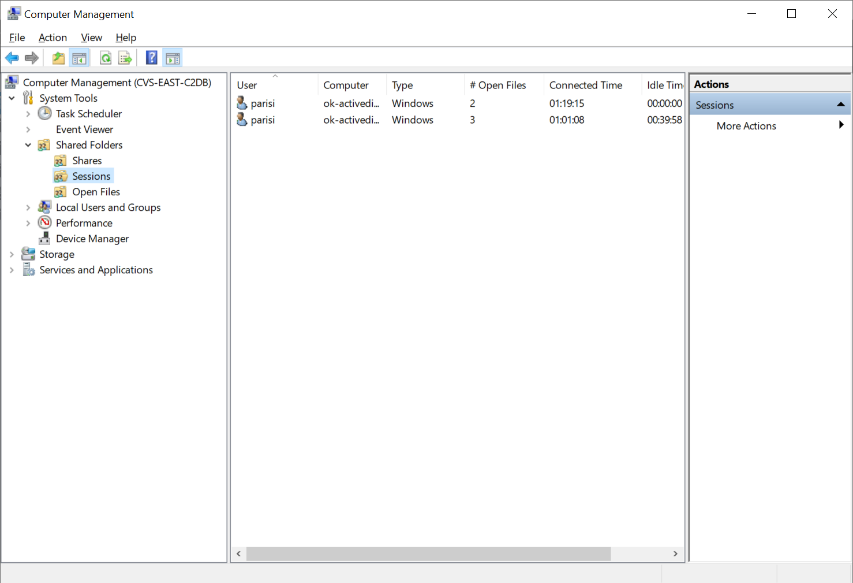

MMC/Computer Management access
SMB access in Google Cloud NetApp Volumes provides connectivity to the Computer Management MMC, which allows you to view shares, manage share ACLs, ands view/manage SMB sessions and open files.
To use the MMC to view SMB shares and sessions in Google Cloud NetApp Volumes, the user logged in currently must be a domain administrator. Other users are allowed access to view or manage the SMB server from MMC and receive a You Do Not Have Permissions dialog box when attempting to view shares or sessions on the Google Cloud NetApp Volumes SMB instance.
To connect to the SMB server, open Computer Management, right click Computer Management and then select Connect To Another Computer. This opens the Select Computer dialog box where you can enter the SMB server name (found in the Google Cloud NetApp Volumes volume information).
When you view SMB shares with the proper permissions, you see all available shares in the Google Cloud NetApp Volumes instance that share the Active Directory connection. To control this behavior, set the Hide SMB Shares option on the Google Cloud NetApp Volumes volume instance.
