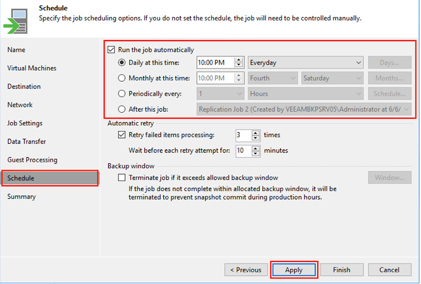

Choose the replication schedule to run the replication job to run on a regular basis.

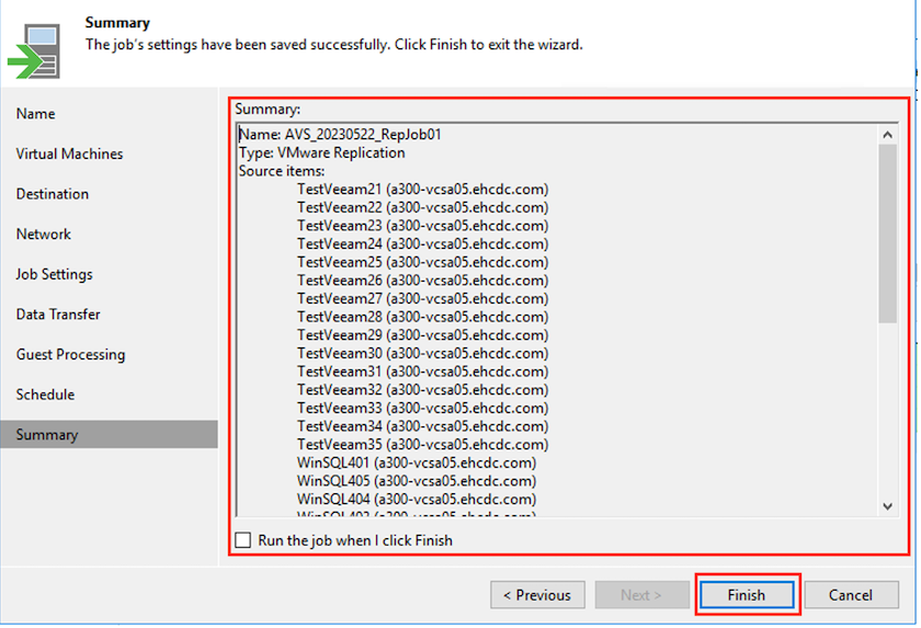

At the Summary step of the wizard, review details of the replication job. To start the job right after the wizard is closed, select the Run the job when I click Finish check box, otherwise leave the check box unselected. Then click Finish to close the wizard.
Once the replication job starts, the VMs with the suffix specified will be populated on the destination AVS SDDC cluster / host.

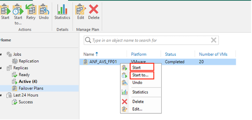

Step 3: Run the failover plan
During failover, the source VM in the production site is switched over to its replica at the disaster recovery site. As part of the failover process, Veeam Backup & Replication restores the VM replica to the required restore point and moves all I/O activities from the source VM to its replica. Replicas can be used not only in case of a disaster, but also to simulate DR drills. During failover simulation, the source VM remains running. Once all the necessary tests have been conducted, you can undo the failover and return to normal operations.
Make sure network segmentation is in place to avoid IP conflicts during failover. |
To start the failover plan, simply click in Failover Plans tab and right click on your failover plan. Select *Start. This will failover using the latest restore points of VM replicas. To fail over to specific restore points of VM replicas, select Start to.

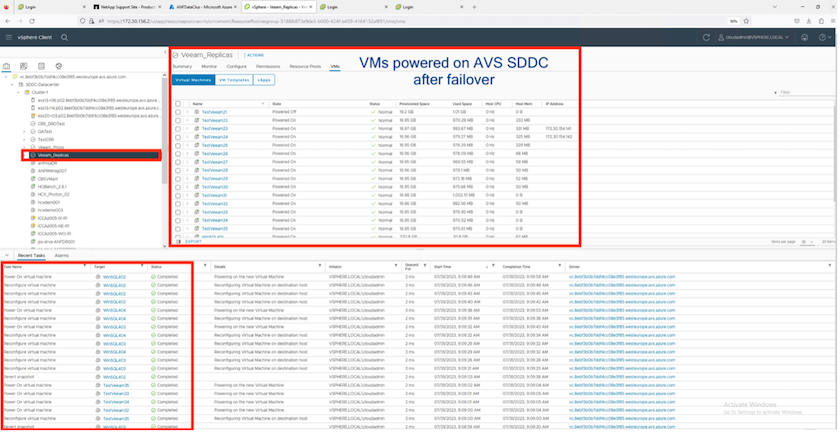

The state of the VM replica changes from Ready to Failover and VMs will start on the destination Azure VMware Solution (AVS) SDDC cluster / host.
Once the failover is complete, the status of the VMs will change to "Failover".

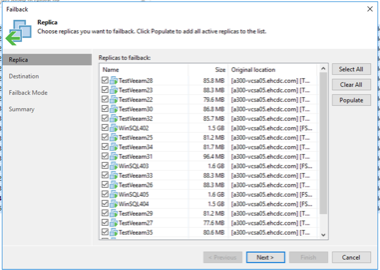

Step 4: Failback to the Production site
When the failover plan is running, it is considered as an intermediate step and needs to be finalized based on the requirement. The options include the following:
Failback to production - switch back to the original VM and transfer all changes that took place while the VM replica was running to the original VM.
When you perform failback, changes are only transferred but not published. Choose Commit failback (once the original VM is confirmed to work as expected) or Undo failback to get back to the VM replica If the original VM is not working as expected. |
Undo failover - switch back to the original VM and discard all changes made to the VM replica while it was running.
Permanent Failover - permanently switch from the original VM to a VM replica and use this replica as the original VM.
In this demo, Failback to production was chosen. Failback to the original VM was selected during the Destination step of the wizard and "Power on VM after restoring" check box was enabled.
Failback commit is one of the ways to finalize failback operation. When failback is committed, it confirms that the changes sent to the VM which is failed back (the production VM) are working as expected. After the commit operation, Veeam Backup & Replication resumes replication activities for the production VM.
For detailed information about the failback process, refer Veeam documentation for Failover and Failback for replication.
After failback to production is successful, the VMs are all restored back to the original production site.
