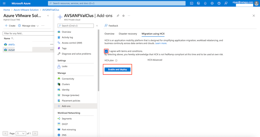

Step 1: Install HCX through Azure Portal using the Add-ons option
To perform the installation, complete the following steps:
Log in to the Azure Portal and access the Azure VMware Solution private cloud.
Select the appropriate private cloud and access Add-ons. This can be done by navigating to Manage > Add-ons.
In the HCX Workload Mobility section, click Get Started.
Select the I Agree with Terms and Conditions option and click Enable and Deploy.
The default deployment is HCX Advanced. Open a support request to enable the Enterprise edition. The deployment takes approximately 25 to 30 minutes.

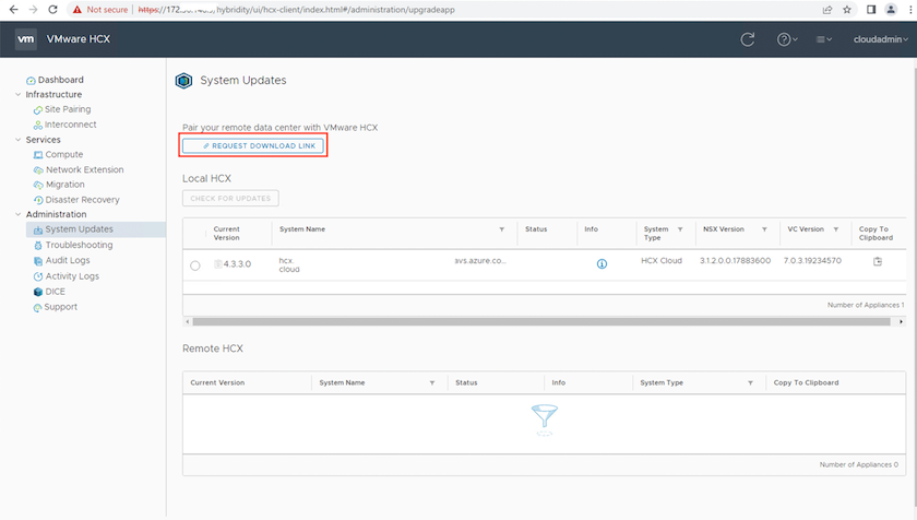

To download and install HCX Connector in the on-premises vCenter Server, complete the following steps:
From the Azure portal, go to the Azure VMware Solution, select the private cloud, and select Manage > Add-ons > Migration using HCX and copy the HCX Cloud Manager portal to download the OVA file.
Use the default CloudAdmin user credentials to access the HCX portal.
After you access the HCX portal with cloudadmin@vsphere.local using the jumphost, navigate to Administration > System Updates and click Request Download Link.
Either download or copy the link to the OVA and paste it into a browser to begin the download process of the VMware HCX Connector OVA file to deploy on the on-premises vCenter Server.

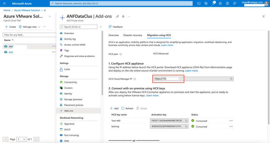

Step 3: Activate HCX Connector with the license key
After you deploy the VMware HCX Connector OVA on-premises and start the appliance, complete the following steps to activate HCX Connector. Generate the license key from the Azure VMware Solution portal and activate it in VMware HCX Manager.
From the Azure portal, go to the Azure VMware Solution, select the private cloud, and select Manage > Add-ons > Migration using HCX.
Under Connect with on-premise Using HCX keys, click Add and copy the activation key.
A separate key is required for each on-premises HCX Connector that is deployed. -

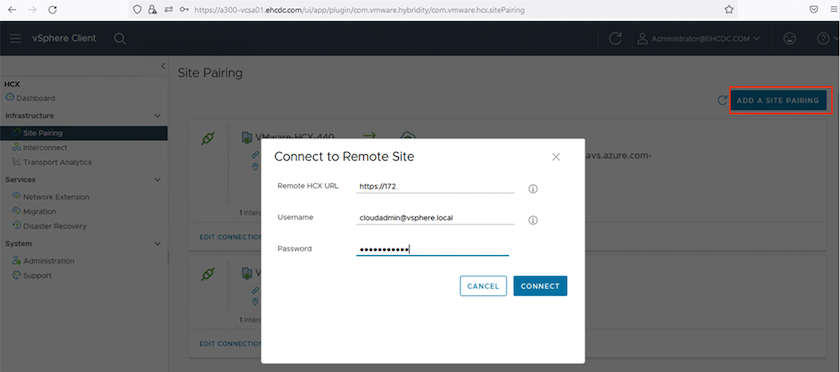

Step 4: Pair on-premises VMware HCX Connector with Azure VMware Solution HCX Cloud Manager
After HCX Connector is installed in both on-premises and Azure VMware Solution, configure the on-premises VMware HCX Connector for Azure VMware Solution private cloud by adding the pairing. To configure the site pairing, complete the following steps:
To create a site pair between the on-premises vCenter environment and Azure VMware Solution SDDC, log in to the on-premises vCenter Server and access the new HCX vSphere Web Client plug-in.
Under Infrastructure, click Add a Site Pairing.
Enter the Azure VMware Solution HCX Cloud Manager URL or IP address and the credentials for CloudAdmin role for accessing the private cloud. |
Click Connect.
VMware HCX Connector must be able to route to HCX Cloud Manager IP over port 443. |
After the pairing is created, the newly configured site pairing is available on the HCX Dashboard.
