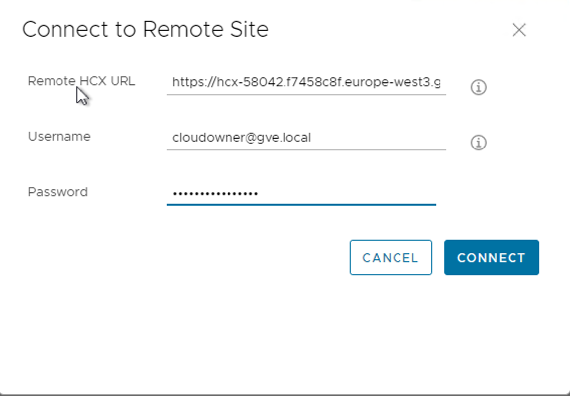

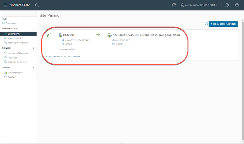

Step 4: Pair on-premises VMware HCX Connector with Google Cloud VMware Engine HCX Cloud Manager
After HCX Connector is deployed and configured on on-premises vCenter, establish connection to Cloud Manager by adding the pairing. To configure the site pairing, complete the following steps:
To create a site pair between the on-premises vCenter environment and Google Cloud VMware Engine SDDC, log in to the on-premises vCenter Server and access the new HCX vSphere Web Client plug-in.
Under Infrastructure, click Add a Site Pairing.
Enter the Google Cloud VMware Engine HCX Cloud Manager URL or IP address and the credentials for user with Cloud-Owner-Role privileges for accessing the private cloud.
Click Connect.
VMware HCX Connector must be able to route to HCX Cloud Manager IP over port 443. -
After the pairing is created, the newly configured site pairing is available on the HCX Dashboard.
