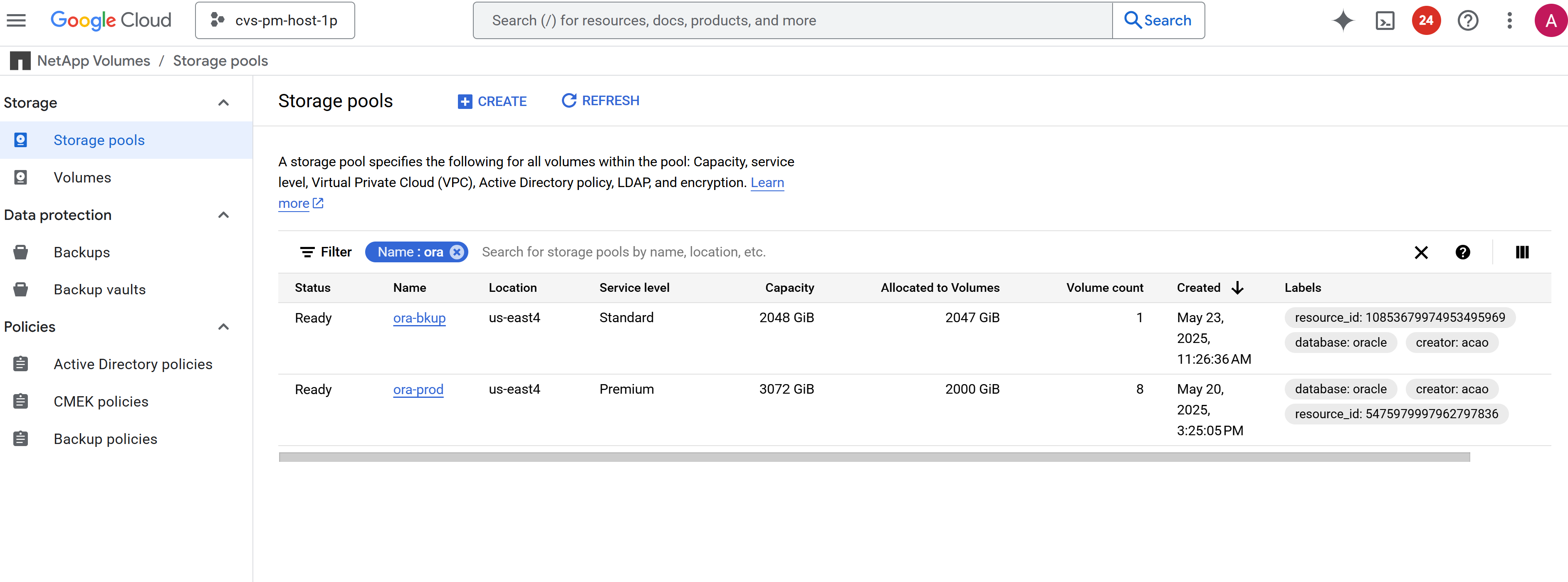

A GCP account has been set up, and the necessary VPC and network configuration have been created within a project in the Google Cloud account.
From the Google Cloud portal console, follow documentation Create a storage pool to create a GCNV storage pool with standard service as shown below.
From the Google Cloud portal console, follow documentation Create a volume to create a volume for in-server Oracle VLDB image backup. In this solution demo, the Oracle VLDB primary storage is also hosted on GCNV as shown below.
