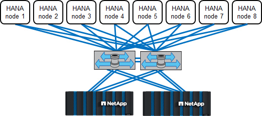

SAP HANA hosts are connected to storage controllers using a redundant FCP infrastructure and multipath software. A redundant FCP switch infrastructure is required to provide fault-tolerant SAP HANA host-to-storage connectivity in case of switch or host bus adapter (HBA) failure. Appropriate zoning must be configured at the switch to allow all HANA hosts to reach the required LUNs on the storage controllers.
Different models of the ASA system product family can be mixed and matched at the storage layer to allow for growth and differing performance and capacity needs. The maximum number of SAP HANA hosts that can be attached to the storage system is defined by the SAP HANA performance requirements and the model of NetApp controller used. The number of required disk shelves is only determined by the capacity and performance requirements of the SAP HANA systems.
The following figure shows an example configuration with eight SAP HANA hosts attached to a storage HA pair.
Eight SAP HANA hosts attached to a storage HA pair

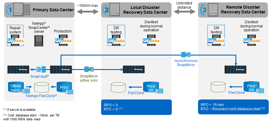

Storage replication based on SnapMirror
The following figure shows a three-site disaster recovery solution using synchronous SnapMirror active sync to the local DR datacenter and asynchronous SnapMirror to replicate the data to the remote DR datacenter.
SnapMirror active sync enables business services to continue operating even through a complete site failure, supporting applications to fail over transparently using a secondary copy (RPO=0 and RTO=0). There is no manual intervention or custom scripting required to trigger a failover with SnapMirror active sync.
Beginning with ONTAP 9.15.1, SnapMirror active sync supports a symmetric active/active capability. Symmetric active/active enable read and write I/O operations from both copies of a protected LUN with bidirectional synchronous replication so that both LUN copies can serve I/O operations locally.
More details can be found at SnapMirror active sync overview in ONTAP..
The RTO for the asynchronous SnapMirror replication primarily depends on the time needed to start the HANA database at the DR site and load the data into memory. With the assumption that the data is read with a throughput of 1000MBps, loading 1TB of data would take approximately 18 minutes.
The servers at the DR sites can be used as dev/test systems during normal operation. In the case of a disaster, the dev/test systems would need to be shut down and started as DR production servers.
Both replication methods allow to you execute DR workflow testing without influencing the RPO and RTO. FlexClone volumes are created on the storage and are attached to the DR testing servers.
Overview of SnapMirror Storage Replication
