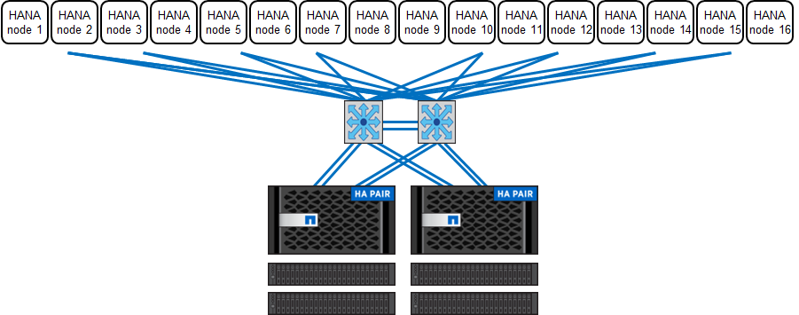

The following figure shows an example configuration in which more SAP HANA hosts are attached to the storage controllers. In this example, more disk shelves are necessary to fulfill both the capacity and performance requirements of 16 SAP HANA hosts. Depending on the total throughput requirements, additional 10GbE (or faster) connections to the storage controllers must be added.
Additional SAP HANA Hosts to an existing storage controller HA pair

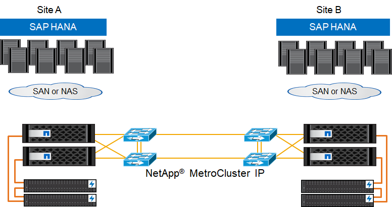

Storage replication based on MetroCluster
The following figure shows a high-level overview of the solution. The storage cluster at each site provides local high availability and is used for the production workload. The data of each site is synchronously replicated to the other location and is available if there is disaster failover.
NetApp MetroCluster IP
