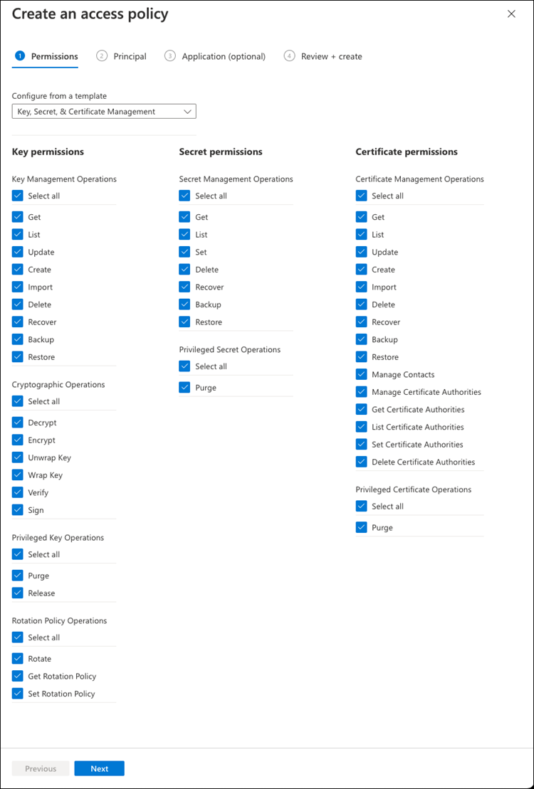

  7. Under Configure from a template, click the drop-down menu and then select the Key, Secret, and Certificate Management template.
  8. Choose each of the drop-down permissions menus (key, secret, certificate) and then Select all at the top of the menu list to select all the permissions available. You should have:
    • Key permissions: 20 selected
    • Secret permissions: 8 selected
    • Certificate permissions: 16 selected
      screenshot of Create an access policy showing all permissions selections needed to create an access policy

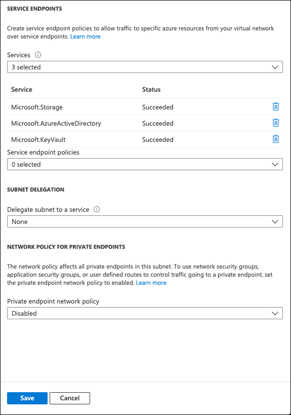

Create an Azure Active Directory Endpoint (HA only)
  1. This process is only required if you are configuring Azure Key Vault for an HA Cloud Volumes ONTAP system.
  2. In the Azure portal navigate to Virtual Networks.
  3. Select the Virtual Network where you deployed the Cloud Volumes ONTAP system and select the Subnets menu on the left side of the page.
  4. Select the subnet name for you Cloud Volumes ONTAP deployment from the list.
  5. Navigate to the Service Endpoints heading. In the drop-down menu, select the following:
    • Microsoft.AzureActiveDirectory
    • Microsoft.KeyVault
    • Microsoft.Storage (optional)
      Screenshot of Service Endpoints showing three selected services
  6. Select Save to capture your settings.
