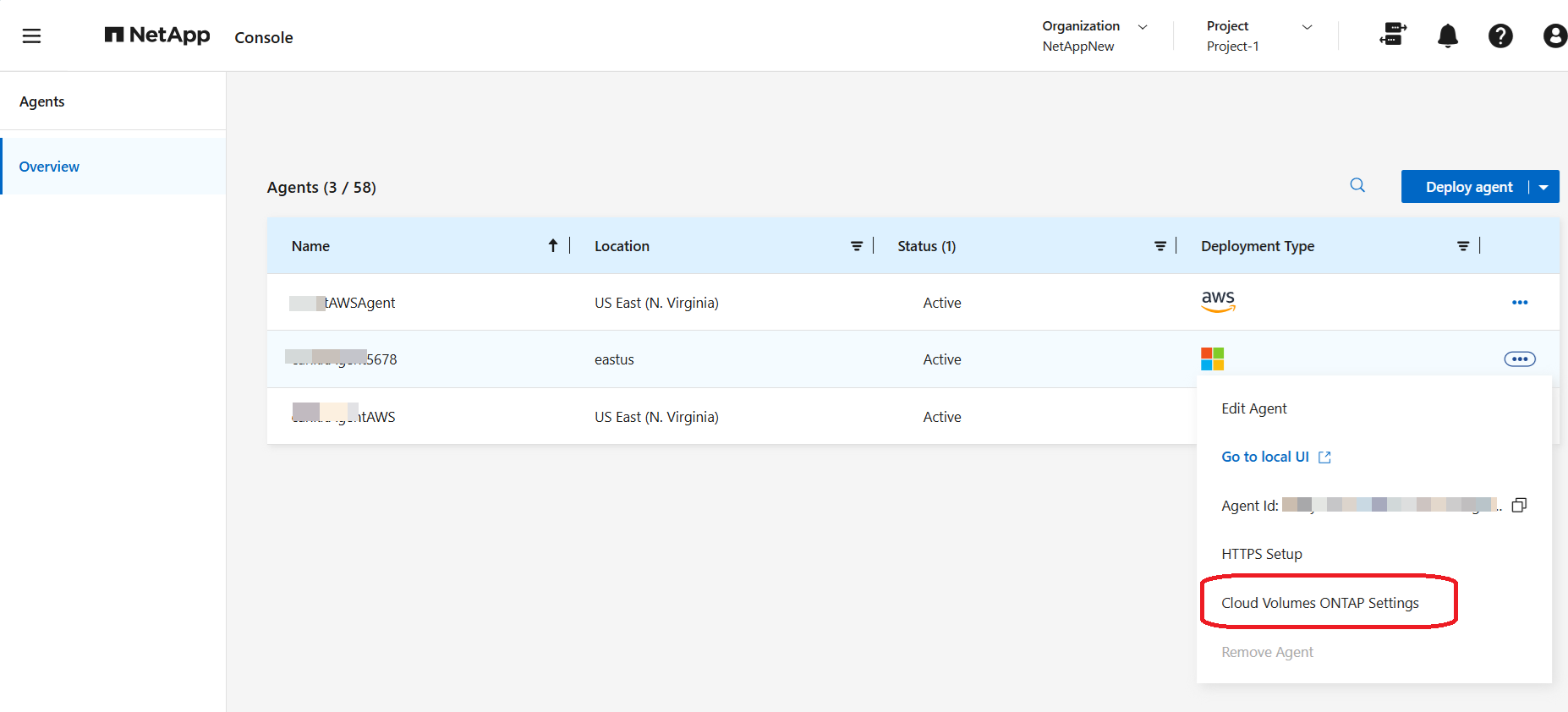

  1. From the left navigation pane, go to Administration > Agents.
  2. Click the An icon that shows three horizontal dots for additional actions icon for the Console agent that manages your Cloud Volumes ONTAP system.
  3. Select Cloud Volumes ONTAP Settings.
    A screenshot of the Cloud Volumes ONTAP Settings option under the Settings icon.
  4. Under Azure, click Use Azure Private Link.
  5. Deselect Private Link connection between Cloud Volumes ONTAP and storage accounts.
  6. Click Save.

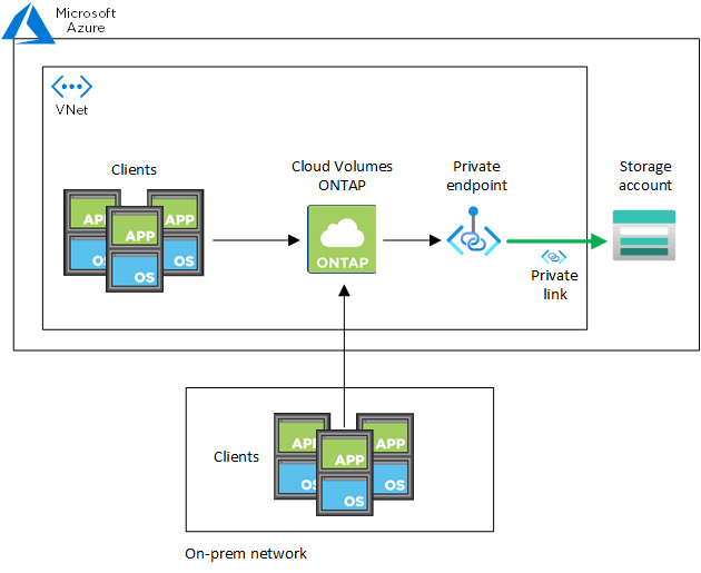

When the Console deploys Cloud Volumes ONTAP in Azure, it creates a private endpoint in the resource group. The private endpoint is associated with storage accounts for Cloud Volumes ONTAP. As a result, access to Cloud Volumes ONTAP storage travels through the Microsoft backbone network.
Client access goes through the private link when clients are within the same VNet as Cloud Volumes ONTAP, within peered VNets, or in your on-premises network when using a private VPN or ExpressRoute connection to the VNet.
Here's an example that shows client access over a private link from within the same VNet and from an on-premises network that has either a private VPN or ExpressRoute connection.
A conceptual image that shows data access going to Cloud Volumes ONTAP and through a private endpoint and private link to the storage account.
Note If the Console agent and Cloud Volumes ONTAP systems are deployed in different VNets, then you must set up VNet peering between the VNet where the Console agent is deployed and the VNet where the Cloud Volumes ONTAP systems are deployed.
