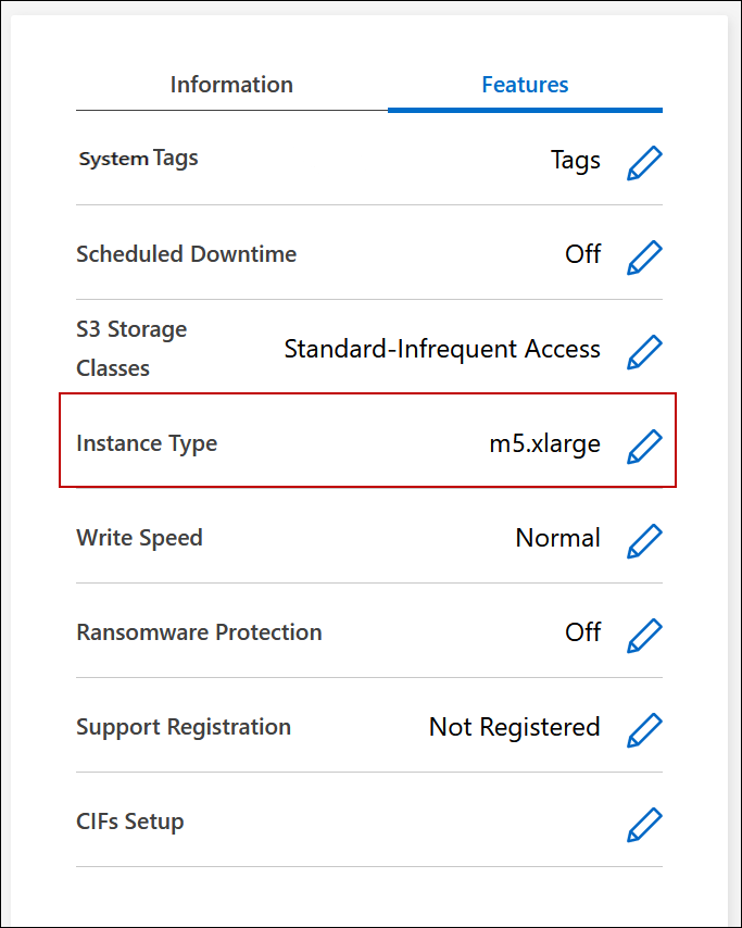

  1. On the Systems page, select the system.
  2. On the Overview tab, click the Features panel and then click the pencil icon next to Instance type.
    400
    If you are using a node-based pay as you go (PAYGO) license, you can optionally choose a different license and instance type by clicking the pencil icon next to License type.
  3. Choose an instance type, select the check box to confirm that you understand the implications of the change, and then click Change.
