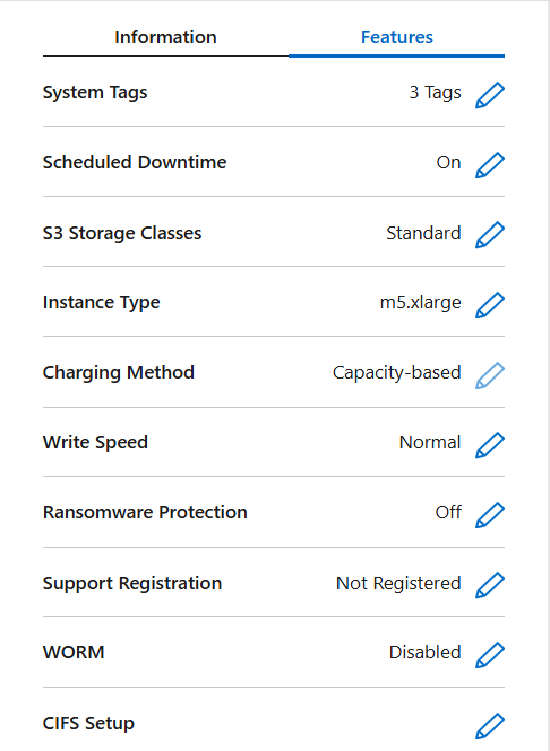

  1. On the Systems page, double-click the Cloud Volumes ONTAP system.
  2. On the Overview tab, select the Features panel and then select the pencil icon next to Scheduled Downtime.
    400
  3. Specify the shutdown schedule:
    1. Choose whether you want to shut down the system every day, every weekday, every weekend, or any combination of the three options.
    2. Specify when you want to turn off the system and for how long you want it turned off.
      Example
      The following image shows a schedule that instructs the Console to shut down the system every Saturday at 20:00 P.M. (8:00 PM) for 12 hours. The Console restarts the system every Monday at 12:00 a.m.
      Screen shot: Shows the Schedule downtime screen.
  4. Select Save.
Result
The schedule is saved. The corresponding Scheduled Downtime line item under the Features panel displays 'On'.
