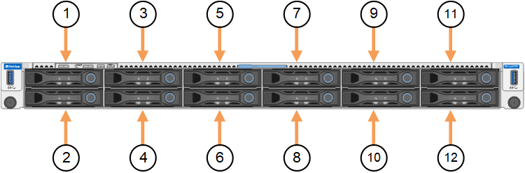

    The twelve drives are in the following positions in the chassis (front of chassis with bezel removed shown):
    Drive locations
    Position Drive
    1
    HDD00
    2
    HDD01
    3
    HDD02
    4
    HDD03
    5
    HDD04
    6
    HDD05
    7
    HDD06
    8
    HDD07
    9
    HDD08
    10
    HDD09
    11
    HDD10
    12
    HDD11
