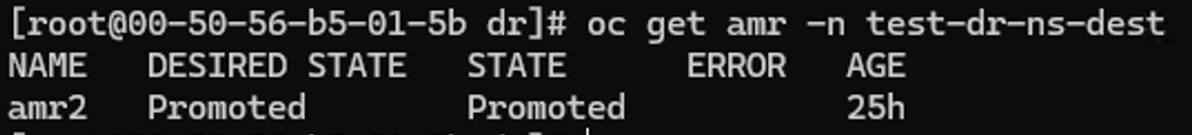

    oc patch amr amr1 -n test-dr-ns-dest --type=merge -p '{"spec":{"desiredState":"Promoted"}}'
    Relación OCP-v AppMirror promocionada
    oc get pod, pvc,vm -n test-dr-ns-dest
