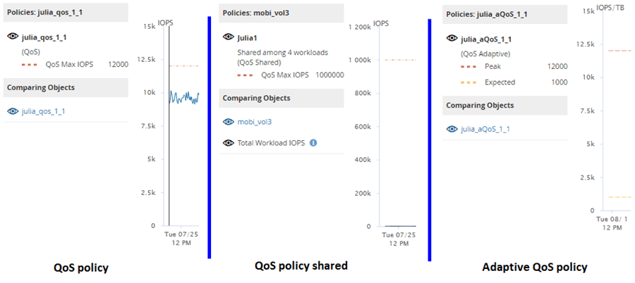

The following figure shows an example of how the three options are shown in the counter charts.
A UI screenshot that shows an example of how the three options are shown in the counter charts.
When a normal QoS policy that has been defined in IOPS appears in the IOPS/TB chart for a workload, ONTAP converts the IOPS value to an IOPS/TB value and Unified Manager displays that policy in the IOPS/TB chart along with the text “QoS, defined in IOPS”.
When an adaptive QoS policy that has been defined in IOPS/TB appears in the IOPS chart for a workload, ONTAP converts the IOPS/TB value to an IOPS value and Unified Manager displays that policy in the IOPS chart along with the text “QoS Adaptive - Used, defined in IOPS/TB” or “QoS Adaptive - Allocated, defined in IOPS/TB” depending on how the peak IOPS allocation setting is configured. When the allocation setting is set to “allocated-space”, the peak IOPS is calculated based on the size of the volume. When the allocation setting is set to “used-space”, the peak IOPS is calculated based on the amount of data stored in the volume, taking into account storage efficiencies.
