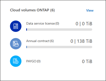

  1. From the left navigation pane, select Administration > Licenses and subscriptions.
  2. On the Overview tab, the Cloud Volumes ONTAP tile displays the current capacity provisioned for your account.
    screenshot cvo licensing card
    • Direct license is the total provisioned capacity of all Cloud Volumes ONTAP systems in your NetApp account. The charging is based on each volume's provisioned size, regardless of local, used, stored, or effective space within the volume.
    • Annual contract is the total licensed capacity (bring your own license (BYOL) or Marketplace Contract) that you purchased from NetApp.
    • PAYGO is the total provisioned capacity using cloud marketplace subscriptions. Charging via PAYGO is used only if the consumed capacity is higher than the licensed capacity or if there is no BYOL license available in the Console.

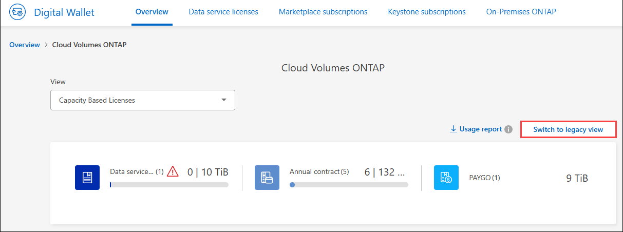

Viewing package details
You can view details about the capacity used per package by switching to legacy mode on the Cloud Volumes ONTAP page.
  3. Select View to see the provisioned capacity for each of your licensing packages.
  4. Select Switch to advanced view.
    A screenshot of the Switch to advanced view button
  5. View the details of the package you want to see.
    A screenshot of switch to standard view button
