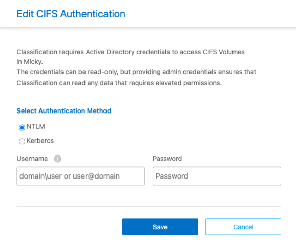

  3. Select the protocol for the file shares you are adding, add the file shares that you want to scan - one file share per line - and click Continue.
    When adding CIFS (SMB) shares, you need to enter the Active Directory credentials that provide read access to the shares. Admin credentials are preferred.
    A screenshot of the Add File Shares page where you can add the shares to be scanned.
