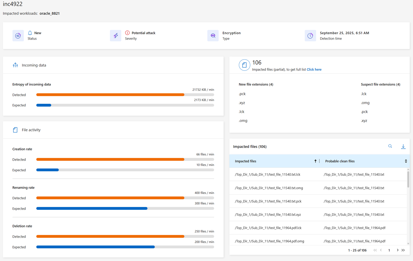

The service provides information called evidence about what caused the alert to be issued, such as the following:
File extensions were created or changed
File creation occurred and increased by a listed percentage
File deletion occurred and increased by a listed percentage
An alert is based on the following types of behavior:
Potential attack: An alert occurs when Autonomous Ransomware Protection detects a new extension and the occurrence is repeated more than 20 times in the last 24 hours (default behavior).
Warning: A warning occurs based on the following behaviors:
Detection of a new extension has not been identified before and the same behavior does not repeat enough times to declare it as an attack.
High entropy is observed.
File read/write/rename/delete operations incurred a 100% surge in activity beyond the baseline.
Evidence is based on information from Autonomous Ransomware Protection in ONTAP. For details, refer to Autonomous Ransomware Protection overview.

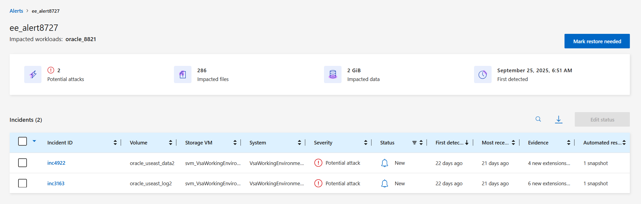

View alerts
You can access alerts from BlueXP ransomware protection Dashboard or from the Alerts tab.
In the BlueXP ransomware protection Dashboard, review the Alerts pane.
Select View all under one of the statues.
Click on an alert to review all incidents on each volume for each alert.
To review additional alerts, click on Alert in the breadcrumbs at the upper left.
Review the alerts on the Alerts page.
Continue with Mark ransomware incidents as ready for recovery (after incidents are neutralized).

From the BlueXP ransomware protection menu, select Alerts.
In the Alerts page, select the alert.
Review the incidents in the alert.
If you determine that the incidents are ready for recovery, select Mark restore needed.
Confirm the action and select Mark restore needed.
To initiate the workload recovery, select Recover workload in the message or select the Recovery tab.
After the alert is marked for recovery, the alert moves from the Alerts tab to the Recovery tab.
