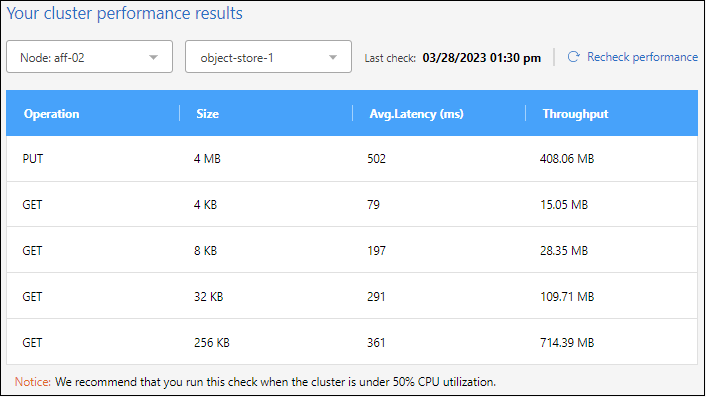

Run a Cloud Performance Test to measure network latency and throughput performance from an ONTAP cluster to an object store before and after setting up data tiering. The test also identifies any failures that occurred.
Here are sample performance results:
A screenshot of cluster performance results for a Cloud Performance Test.

  3. Select a node from the drop-down list.
  4. View the results or recheck the performance.
