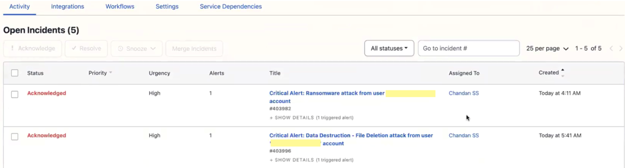

Go to Incidents or Services to view Alerts.

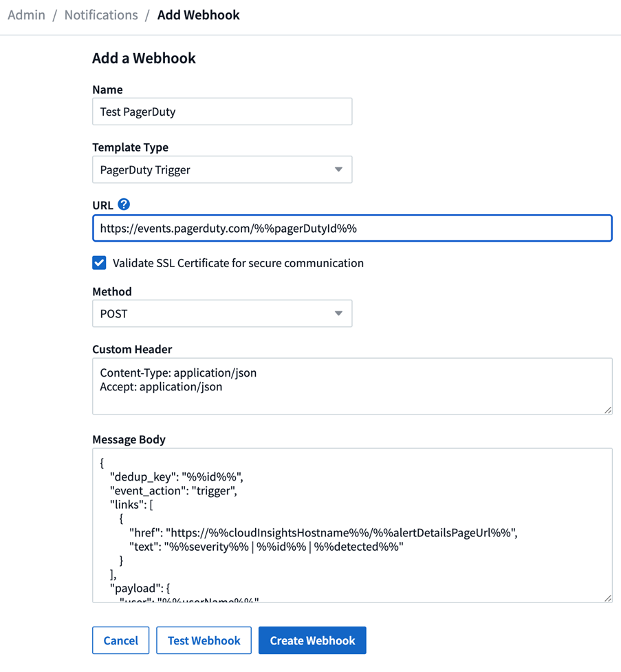

Navigate to Admin > Notifications and select the Workload Security Webhooks tab. Select '+ Webhook' to create a new webhook.
Give the webhook a meaningful name.
In the Template Type dropdown, select PagerDuty Trigger.
Create a custom parameter secret named routingKey and set the value to the PagerDuty Integration Key created above.
