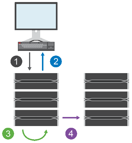

Asynchronous mirroring session
Asynchronous mirroring captures the state of the primary volume at a particular point in time and copies just the data that has changed since the last image capture. Asynchronous mirroring allows the primary site to be updated immediately and the secondary site to be updated as bandwidth allows. The information is cached and sent later, as network resources become available.
There are four primary steps in an active asynchronous mirroring session.
  1. A write operation first occurs on the primary volume's storage array.
  2. The status of the operation is returned to the host.
  3. All changes on the primary volume are logged and tracked.
  4. All changes are sent to the secondary volume's storage array as a background process.
These steps are repeated according to the defined synchronization intervals or the steps can be repeated manually if no intervals are defined.
