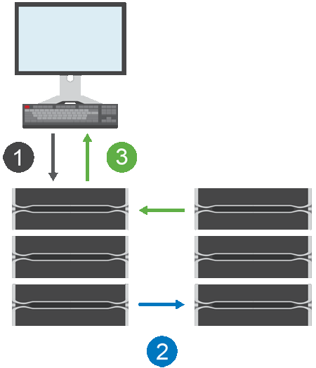

The synchronous mirroring configuration process involves configuring volumes into pairs. After you create a mirrored pair, which consists of a primary volume on one storage array and a secondary volume on another storage array, you can start synchronous mirroring. The steps in synchronous mirroring are depicted below.
Synchronous mirroring session
  1. A write comes in from the host.
  2. The write is committed to the primary volume, propagated to the remote system, and then committed to the secondary volume.
  3. The primary volume's storage array sends an I/O completion message to the host system after both write operations have been successfully completed.
Reserved capacity is used to log information about the incoming write request from a host.
When the current controller owner of the primary volume receives a write request from a host, the controller first logs information about the write to the primary volume's reserved capacity. It then writes the data to the primary volume. Next, the controller initiates a remote write operation to copy the affected data blocks to the secondary volume at the remote storage array.
Because the host application must wait for the write to occur on the local storage array and across the network on the remote storage array, a very fast connection between the local storage array and remote storage array is required to maintain the mirror relationship without overly reducing local I/O performance.
