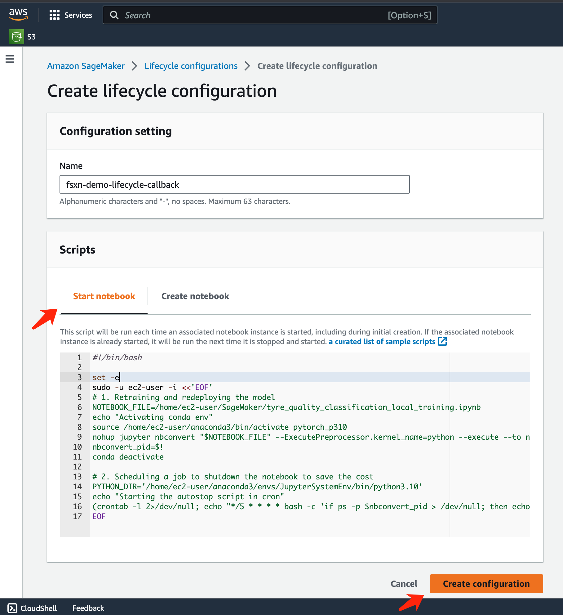

Lifecycle configurations
To configure the lifecycle callback function for the AWS SageMaker Notebook instance, you would utilize Lifecycle configurations. This service allow you to define the necessary actions to be performed during when spinning up the notebook instance. Specifically, a shell script can be implemented within the Lifecycle configurations to automatically shut down the notebook instance once the training and deployment processes are completed. This is a required configuration as the cost is one of the major consideration in MLOps.
It's important to note that the configuration for Lifecycle configurations needs to be set up in advance. Therefore, it is recommended to prioritize configuring this aspect before proceeding with the other MLOps pipeline setup.
  1. To set up a Lifecycle configurations, open the Sagemaker panel and navigate to Lifecycle configurations under the section Admin configurations.
    SageMaker panel
  2. Select the Notebook Instance tab and click the Create configuration button
    Lifecycle configuration welcome page
  3. Paste the below code to the entry area.
    #!/bin/bash
    set -e
    sudo -u ec2-user -i <<'EOF'
    # 1. Retraining and redeploying the model
    NOTEBOOK_FILE=/home/ec2-user/SageMaker/tyre_quality_classification_local_training.ipynb
    echo "Activating conda env"
    source /home/ec2-user/anaconda3/bin/activate pytorch_p310
    nohup jupyter nbconvert "$NOTEBOOK_FILE" --ExecutePreprocessor.kernel_name=python --execute --to notebook &
    nbconvert_pid=$!
    conda deactivate
    # 2. Scheduling a job to shutdown the notebook to save the cost
    PYTHON_DIR='/home/ec2-user/anaconda3/envs/JupyterSystemEnv/bin/python3.10'
    echo "Starting the autostop script in cron"
    (crontab -l 2>/dev/null; echo "*/5 * * * * bash -c 'if ps -p $nbconvert_pid > /dev/null; then echo \"Notebook is still running.\" >> /var/log/jupyter.log; else echo \"Notebook execution completed.\" >> /var/log/jupyter.log; $PYTHON_DIR -c \"import boto3;boto3.client(\'sagemaker\').stop_notebook_instance(NotebookInstanceName=get_notebook_name())\" >> /var/log/jupyter.log; fi'") | crontab -
    EOF
  4. This script executes the Jupyter Notebook, which handles the retraining and redeployment of the model for inference. After the execution is complete, the notebook will automatically shut down within 5 minutes. To learn more about the problem statement and the code implementation, please refer to Part 2 - Leveraging Amazon FSx for NetApp ONTAP (FSx ONTAP) as a Data Source for Model Training in SageMaker.

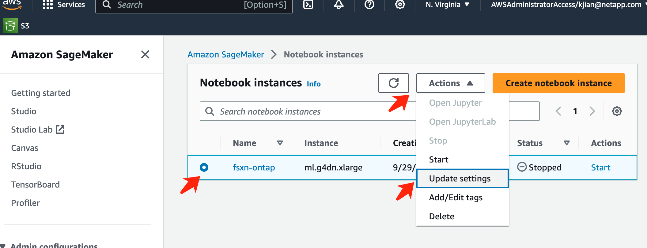

  5. After the creation, navigate to Notebook instances, select the target instance, and click Update settings under Actions dropdown.
    Update settings dropdown

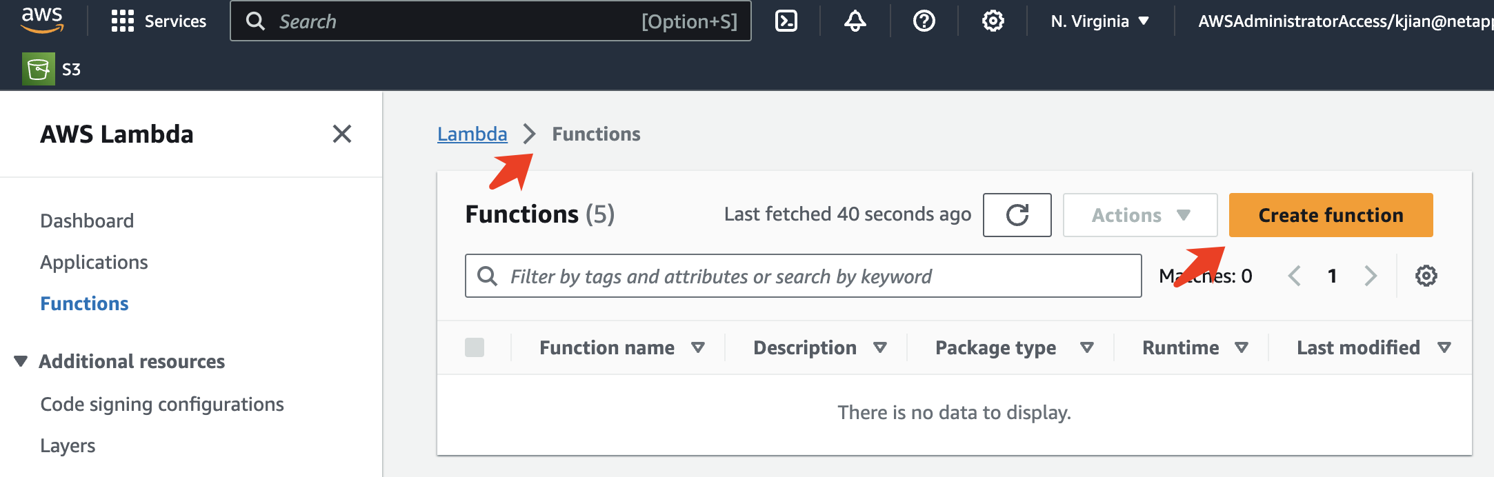

As mentioned earlier, the AWS Lambda function is responsible for spinning up the AWS SageMaker Notebook instance.
  1. To create an AWS Lambda function, navigate to the respective panel, switch to the Functions tab, and click on Create Function.

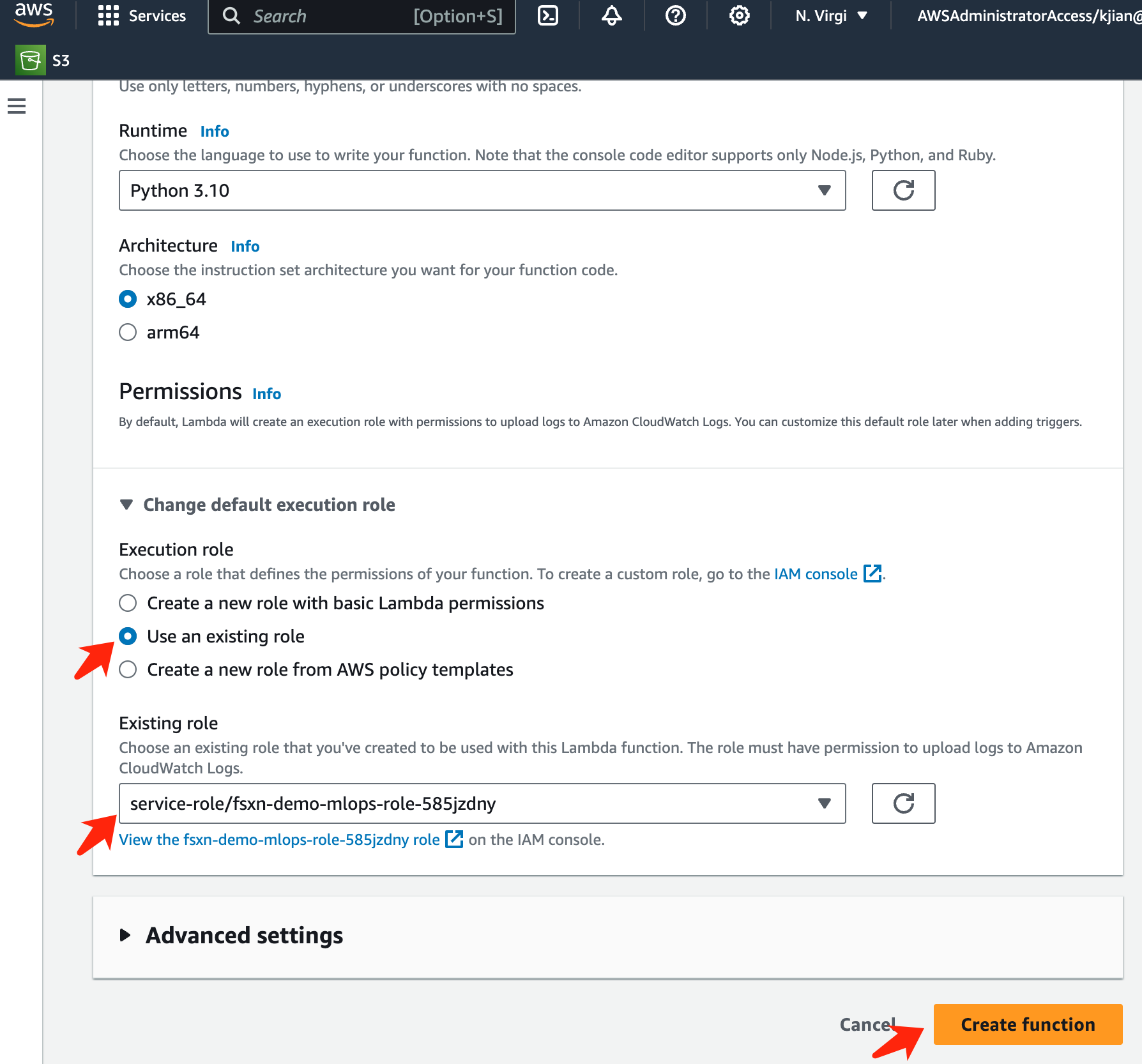

  2. Please file all required entries on the page and remember to switch the Runtime to Python 3.10.
    Create an AWS lambda function
  3. Please verify that the designated role has the required permission AmazonSageMakerFullAccess and click on the Create function button.
