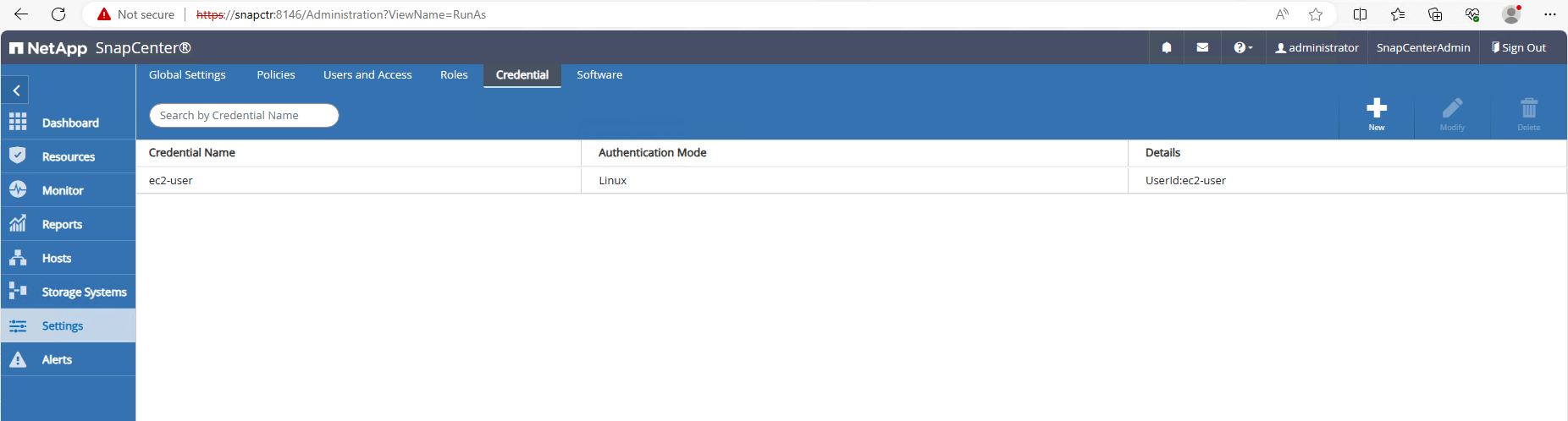

  3. Add AWS ec2-user to Credential in Settings.
    Screenshot showing this step in the GUI.

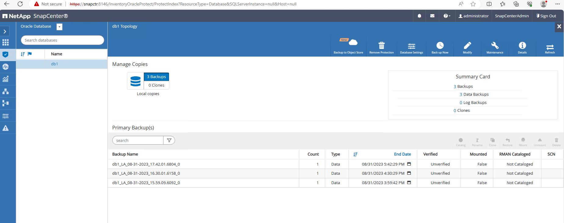

  7. Click on database name to open the database backups page. Select a backup to be used for database clone and click on Clone button to launch clone workflow.

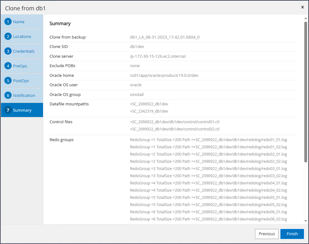

  8. Select Complete Database Clone and name the clone instance SID.

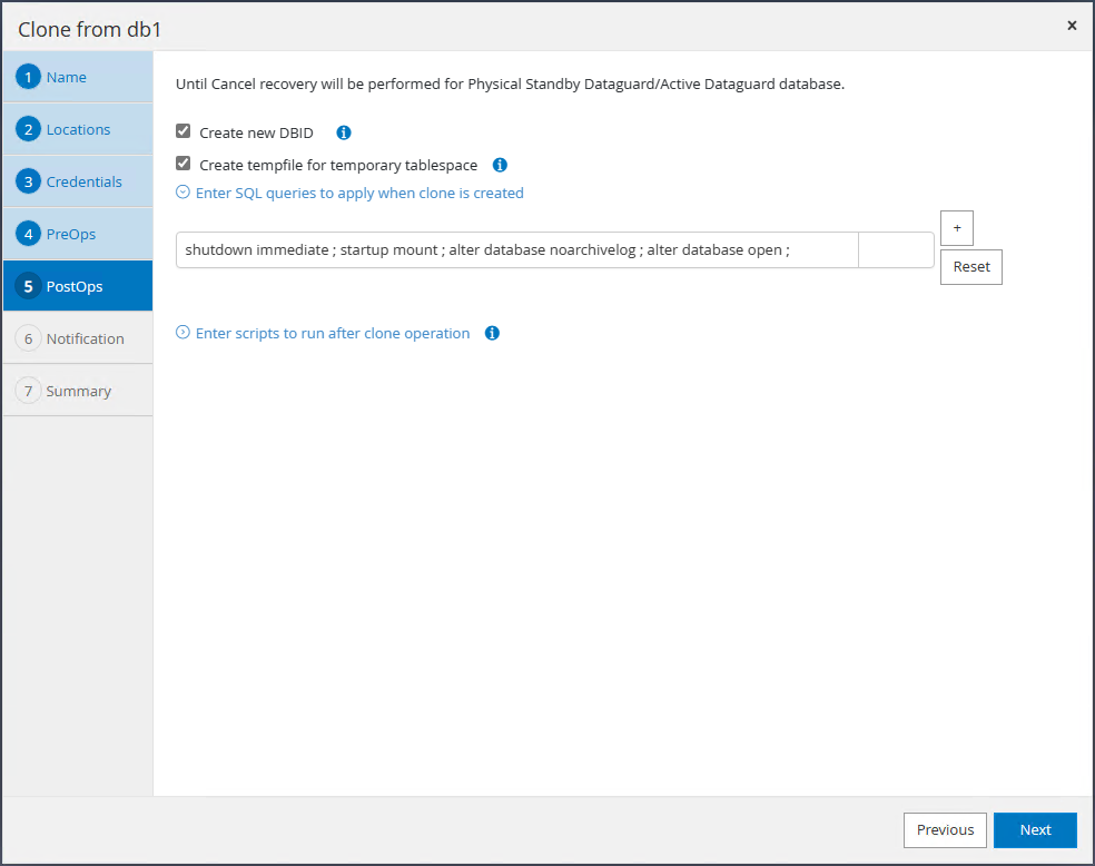

  9. Select the clone host, which hosts the cloned database from standby DB. Accept the default for data files, control files, and redo logs. Two ASM disk groups will be created on the clone host that are corresponding to the disk groups on standby database.

  12. Enter SQL to run after clone. In the demo, we executed commands to turn off database archive mode for a dev/test/report database.

  14. Review the summary, click Finish to start the clone.

  16. Validate the clone database from SnapCenter, which is immediately registered in Resources tab right after clone operation.
