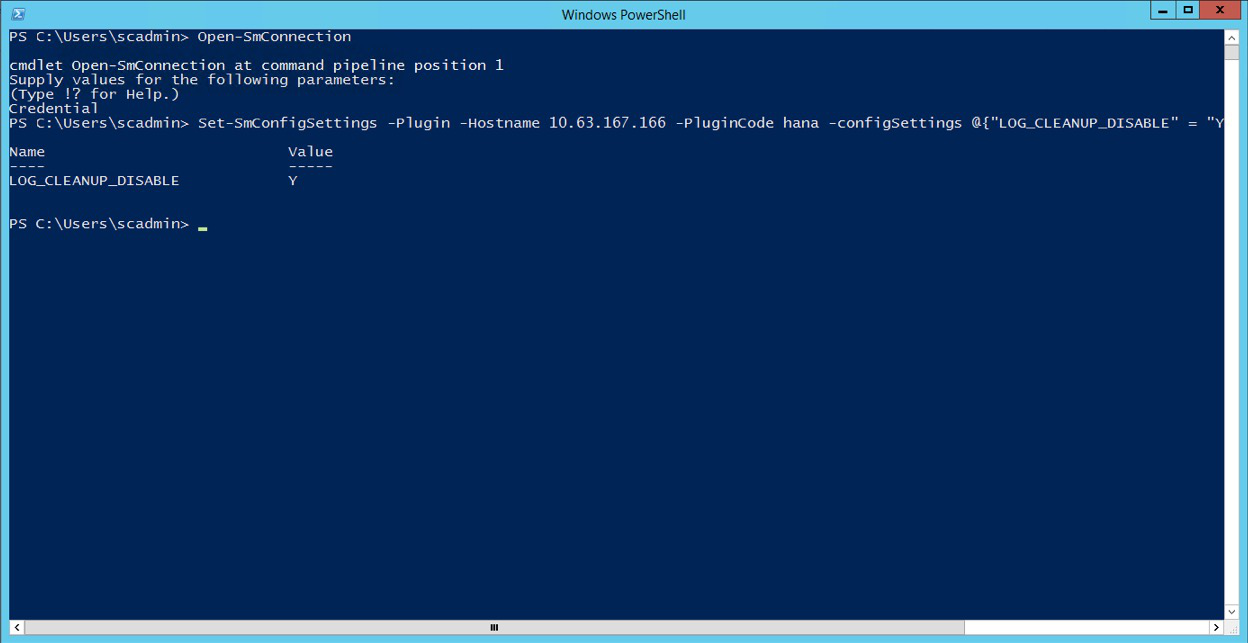

Use the PowerShell command
A second option to configure these settings is using a SnapCenter PowerShell command.
  1. On the SnapCenter server, open a PowerShell. Connect to the SnapCenter server using the command Open- SmConnection and specify user name and password in the opening login window.
  2. With the command Set- SmConfigSettings -Plugin - HostName <pluginhostname> - PluginCode hana - configSettings @{"LOG_CLEANUP_DISABLE" = "Y"}, the changes are configured for the SAP HANA plug-in host <pluginhostname> specified by the IP or host name (see the following figure).
