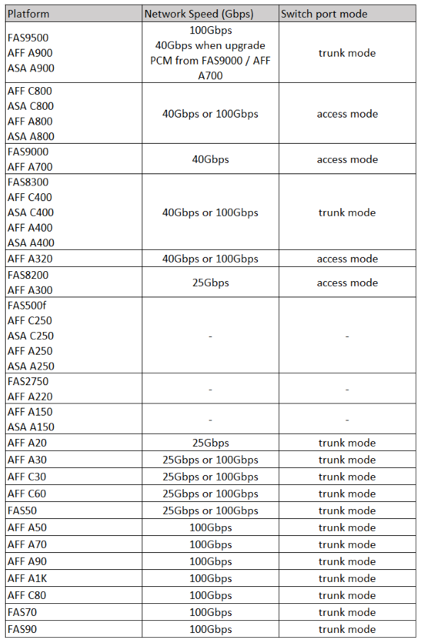

The following table provides platform-specific network speeds and switch port modes for MetroCluster-compliant switches. You should configure the switch port mode according to the table.

Platform Network speed (Gbps) Switch port mode
FAS9500
AFF A900
ASA A900
100Gbps
40Gbps when upgrading PCM from FAS9000 or AFF A700
Trunk mode
AFF C800
ASA C800
AFF A800
ASA A800
40Gbps or 100Gbps
Access mode
FAS9000
AFF A700
40Gbps
Access mode
FAS8300
AFF C400
ASA C400
AFF A400
ASA A400
40Gbps or 100Gbps
Trunk mode
AFF A320
40Gbps or 100Gbps
Access mode
FAS8200
AFF A300
25Gbps
Access mode
FAS500f
AFF C250
ASA C250
AFF A250
ASA A250
FAS2750
AFF A220
AFF A150
ASA A150
AFF A20
25Gbps
Trunk mode
AFF A30
25Gbps or 100Gbps
Trunk mode
AFF C30
25Gbps or 100Gbps
Trunk mode
AFF C60
25Gbps or 100Gbps
Trunk mode
FAS50
25Gbps or 100Gbps
Trunk mode
AFF A50
100Gbps
Trunk mode
AFF A70
100Gbps
Trunk mode
AFF A90
100Gbps
Trunk mode
AFF A1K
100Gbps
Trunk mode
AFF C80
100Gbps
Trunk mode
FAS70
100Gbps
Trunk mode
FAS90
100Gbps
Trunk mode
