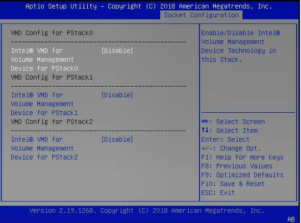

  3. Some servers offer support for Intel Volume Management Device (Intel VMD). When enabled, this makes the available NVMe devices invisible to the ESXi or KVM hypervisor; disable this option before proceeding.
    Socket Configuration

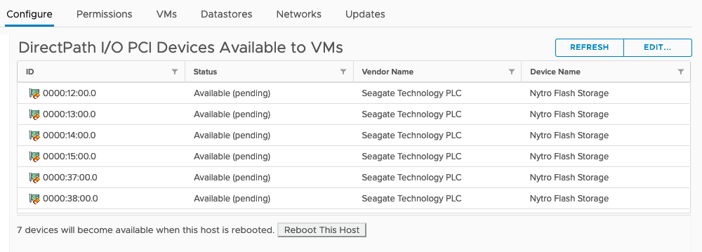

  4. Configure the NVMe drives for pass-through to virtual machines.
    1. In vSphere, open the host Configure view and select Edit under Hardware: PCI devices.
    2. Select the NVMe drives you want to use for ONTAP Select.
      The following example output shows the available drives for an ESXi host:
      Edit PCI Device Availability
      Note You need a VMFS datastore that is also backed by an NVMe device to host the ONTAP Select VM system disks and virtual NVRAM. Leave at least one NVMe drive available for this purpose when configuring the others for PCI pass-through.
    3. Select OK. The selected devices indicate Available (pending).
  5. Select Reboot This Host.
    The following example output is for an ESXi host:
    Reboot This Host

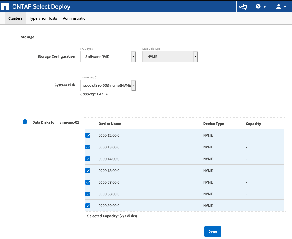

Step 2: Install the ONTAP Select Deploy utility
After the hosts are prepared, you can install the ONTAP Select Deploy utility. Deploy guides you through creating ONTAP Select storage clusters on your newly prepared hosts. During this process, Deploy detects the presence of the NVMe drives configured for pass-through and automatically selects them for use as ONTAP data disks. You can adjust the default selection if needed.
Note A maximum of 14 NVMe devices are supported for each ONTAP Select node.
ONTAP Select Deploy Clusters

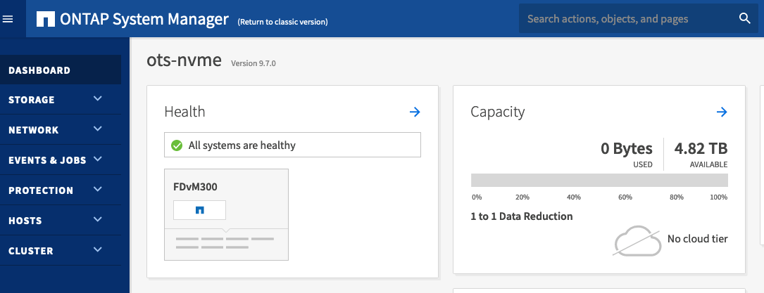

After the cluster is successfully deployed, ONTAP System Manager allows you to provision the storage according to best practices. ONTAP automatically enables flash-optimized storage efficiency features that make the best use of your NVMe storage.
preparing local storage
