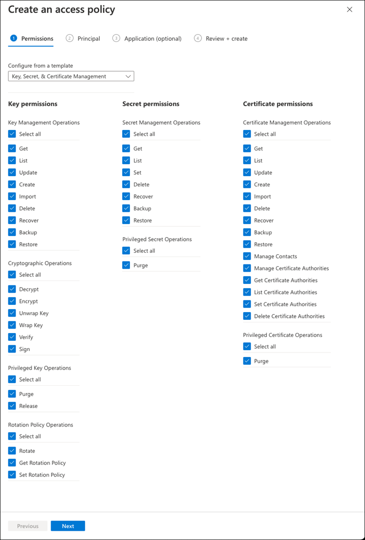

  7. Under Configure from a template, select the drop-down menu and then select the Key, Secret, and Certificate Management template.
  8. Choose each of the drop-down permissions menus (key, secret, certificate) and then Select all at the top of the menu list to select all the permissions available. You should have:
    • Key permissions: 20 selected
    • Secret permissions: 8 selected
    • Certificate permissions: 16 selected
      screenshot of Create an access policy showing all permissions selections needed to create an access policy

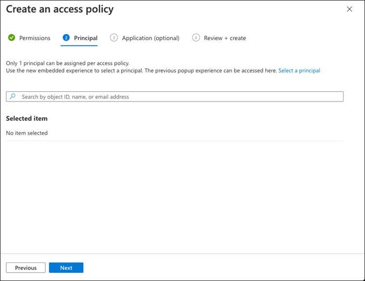

  9. Select Next to select the Principal Azure registered application you created in Azure Application Registration. Select Next.
    Note Only one principal can be assigned per policy.
