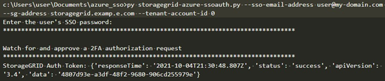

  3. When prompted, enter values for the following arguments (or pass them in using parameters):
    • The SSO email address used to sign in to Entra ID
    • The address for StorageGRID
    • The tenant account ID, if you want to access the Tenant Management API
  4. When prompted, enter the password and be prepared to provide an MFA authorization to Entra ID if requested.
    Prompt to enter password and MFA
    Note The script assumes MFA is done using Microsoft Authenticator. You might need to modify the script to support other forms of MFA (such as entering a code received in a text message).
    The StorageGRID authorization token is provided in the output. You can now use the token for other requests, similar to how you would use the API if SSO was not being used.
