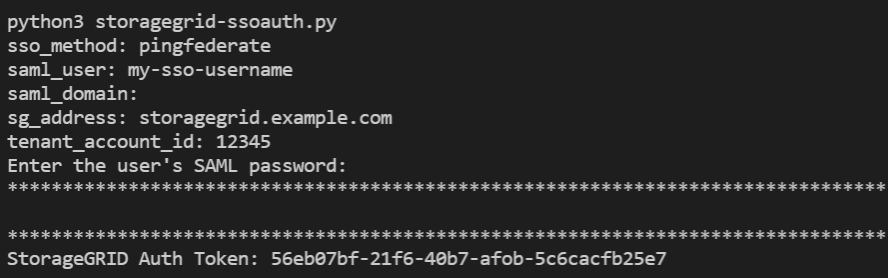

  2. If you want to use the storagegrid-ssoauth.py script, pass the script to the Python interpreter and run the script.
    When prompted, enter values for the following arguments:
    • The SSO method. You can enter any variation of "pingfederate" (PINGFEDERATE, pingfederate, and so on).
    • The SSO username
    • The domain where StorageGRID is installed. This field is not used for PingFederate. You can leave it blank or enter any value.
    • The address for StorageGRID
    • The tenant account ID, if you want to access the Tenant Management API.
      SSO Authentication Script for Ping Federate
      The StorageGRID authorization token is provided in the output. You can now use the token for other requests, similar to how you would use the API if SSO was not being used.
