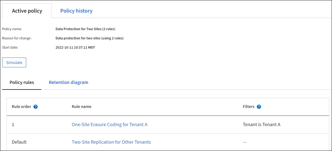

Active ILM policy for example 6: Data protection at two sites
In this example, the active ILM policy was initially designed for a two-site StorageGRID system and uses two ILM rules.
Example ILM Policy 6 Active Policy
In this ILM policy, objects belonging to Tenant A are protected by 2+1 erasure coding at a single site, while objects belonging to all other tenants are protected across two sites using 2-copy replication.
Rule 1: One-site erasure coding for Tenant A
Rule definition Example value
Rule name
One-Site Erasure Coding for Tenant A
Tenant Account
Tenant A
Storage Pool
Site 1
Placements
2+1 erasure coding in Site 1 from day 0 to forever
Rule 2: Two-site replication for other tenants
Rule name
Two-Site Replication for Other Tenants
Tenant Account
Ignore
Storage Pools
Site 1 and Site 2
Placements
Two replicated copies from day 0 to forever: one copy at Site 1 and one copy at Site 2.
