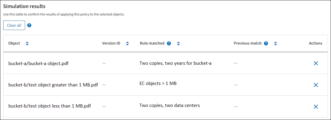

In this example:
  • bucket-a/bucket-a object.pdf correctly matched the first rule, which filters on objects in bucket-a.
  • bucket-b/test object greater than 1 MB.pdf is in bucket-b, so it did not match the first rule. Instead, it was correctly matched by the second rule, which filters on objects greater than 1 MB.
  • bucket-b/test object less than 1 MB.pdf did not match the filters in the first two rules, so it will be placed by the default rule, which includes no filters.

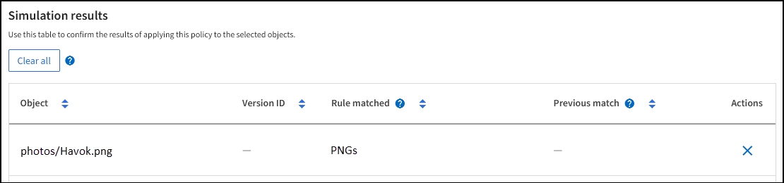

  1. After adding the rules and saving the policy, select Simulate.
  2. In the Object field, enter the S3 bucket/object-key for a test object and select Simulate.
    The Simulation results appear, showing that the Havok.png object was matched by the PNGs rule.
    Example 2: Reordering rules when simulating an ILM policy
    However, Havok.png was meant to test the X-men rule.

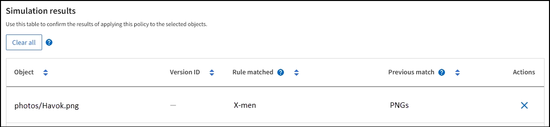

  4. Select Simulate.
    The objects you previously tested are re-evaluated against the updated policy, and the new simulation results are shown. In the example, the Rule matched column shows that the Havok.png object now matches the X-men metadata rule, as expected. The Previous match column shows that the PNGs rule matched the object in the previous simulation.

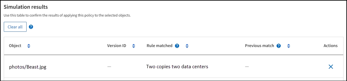

In this example, the Demo policy is being simulated. This policy is intended to find objects that have series=x-men user metadata. However, unexpected results occurred when simulating this policy against the Beast.jpg object. Instead of matching the X-men metadata rule, the object matched the default rule, Two copies two data centers.
Example 3: Correcting a rule when simulating an ILM policy
When a test object is not matched by the expected rule in the policy, you must examine each rule in the policy and correct any errors.
Steps
  1. Select Finish to close the Simulate policy dialog. On the details page for the policy, select Retention diagram. Then select Expand all or View details for each rule as needed.
  2. Review the rule's tenant account, reference time, and filtering criteria.
    As an example, suppose the metadata for the X-men rule was entered as "x-men01" instead of "x-men."
  3. To resolve the error, correct the rule as follows:
    • If the rule is part of the policy, you can either clone the rule or remove the rule from the policy and then edit it.
    • If the rule is part of the active policy, you must clone the rule. You can't edit or remove a rule from the active policy.
  4. Perform the simulation again.
    In this example, the corrected X-men rule now matches the Beast.jpg object based on the series=x-men user metadata, as expected.
