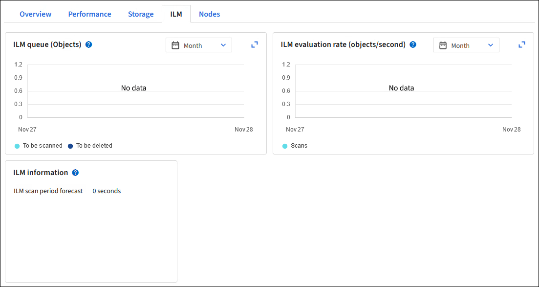

View ILM metrics
You can view metrics for ILM, such as the number of objects in the queue and the evaluation rate. You can monitor these metrics to determine system performance. A large queue or evaluation rate might indicate that the system is not able to keep up with the ingest rate, the load from the client applications is excessive, or that some abnormal condition exists.
Steps
  1. Select Dashboard > ILM.
    Note Because the dashboard can be customized, the ILM tab might not be available.
  2. Monitor the metrics on the ILM tab.
    You can select the question mark question mark icon to see a description of the items on the ILM tab.
    ILM metrics on Grid Manager dashboard
