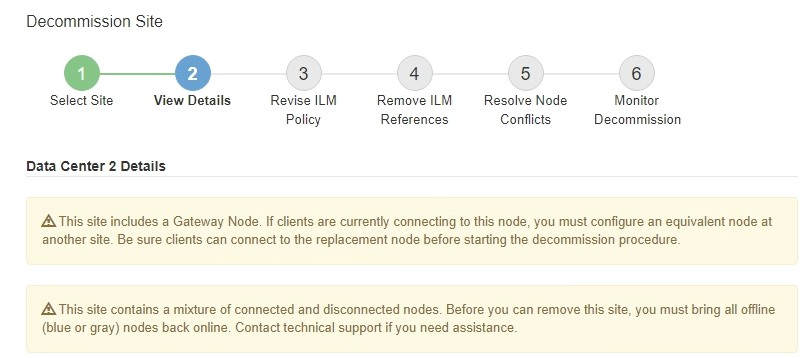

  1. From Step 2 (View Details), review any warnings related to the site you selected to remove.
    Decommission Site Step 2 Site Warnings
    A warning appears in these cases:
    • The site includes a Gateway Node. If S3 clients are currently connecting to this node, you must configure an equivalent node at another site. Be sure clients can connect to the replacement node before continuing with the decommission procedure.
    • The site contains a mixture of connected (Icon Alert Green check mark) and disconnected nodes (Icon Alarm Gray Administratively Down or Icon Alarm Blue Unknown). Before you can remove this site, you must bring all offline nodes back online.

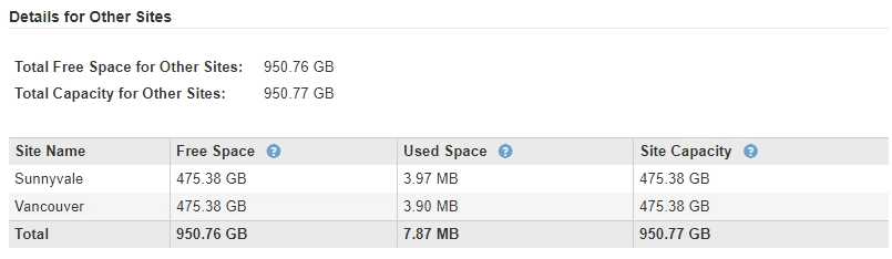

  3. In the Details for Other Sites section of the page, assess how much space is available at the other sites in your grid.
    Decommission Site Step 2 View Details for Other Sites
    If you are performing a connected site decommission and you plan to use ILM to move object data from the selected site (instead of just deleting it), you must ensure that the other sites have enough capacity to accommodate the moved data and that adequate capacity remains for future growth.
    Note A warning appears if the Used Space for the site you want to remove is greater than the Total Free Space for Other Sites. To ensure that adequate storage capacity is available after the site is removed, you might need to perform an expansion before performing this procedure.
