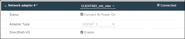

  1. In vCenter, add a new network adapter (type VMXNET3) to an Admin Node and Gateway Node VM. Select Connected and Connect At Power On checkboxes.
    vCenter
