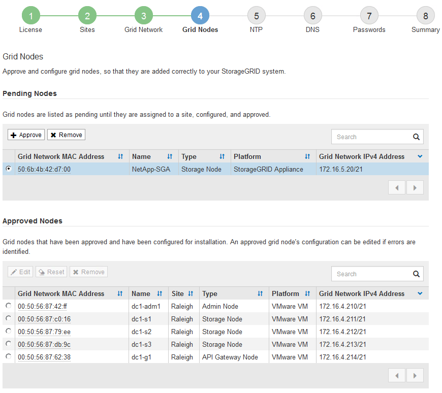

  2. Select the radio button next to a pending node you want to approve.
    This image is explained by the surrounding text.
  3. Click Approve.

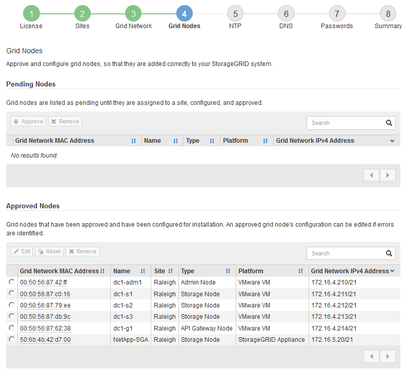

  8. Click Save.
    The grid node entry moves to the Approved Nodes list.
  9. Repeat these steps for each pending grid node you want to approve.
    You must approve all nodes that you want in the grid. However, you can return to this page at any time before you click Install on the Summary page. You can modify the properties of an approved grid node by selecting its radio button and clicking Edit.
