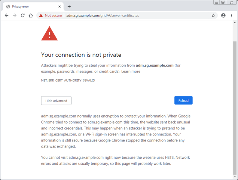

The following example shows a certificate error when the custom management interface certificate expired:
Example certificate error
