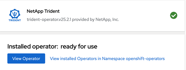

    Once the installation is complete, the Operator is visible in the list of installed operators and it is ready to use.
  5. Click View Operator to view the details of the Operator.
    Installed
