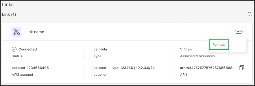

You can remove a link that you're no longer using in your environment. Any FSx for ONTAP file systems or other resources that were using the link will be unable to use certain functionality after the link is removed.
Note that the link is only deleted from Workload Factory - it is not deleted from your AWS environment. You must delete the Lambda function from your AWS account after removing the link in Workload Factory.
Steps
  1. Log in using one of the console experiences.
  2. Select the menu The hamburger menu icon is used to navigate to workloads like storage and then select Storage.
  3. From the Storage menu, select Administration and then Links.
    Existing links appear on the Links page.
  4. From the Links page, select the actions menu of the link to remove and then select Remove.
    A screenshot showing how to remove a link from Workload Factory.
  5. If you are sure, select Remove again.
Refer to the AWS documentation to delete the Lambda function.
