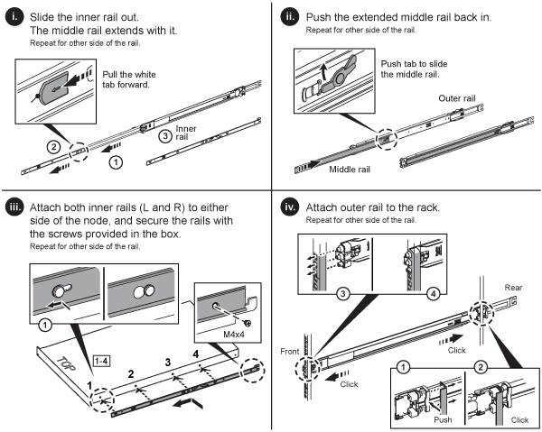

H610S
Here is an illustration for installing rails for an H610S storage node:
There are left and right rails on the H610S. Position the screw hole towards the bottom so that the H610S thumbscrew can secure the chassis to the rail. |
