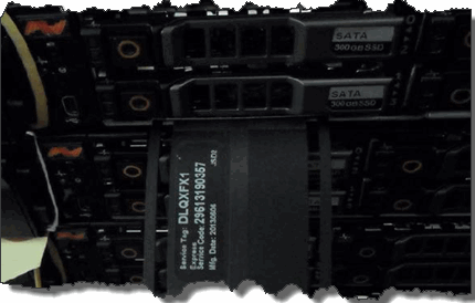

  1. Locate the service tag of the failed chassis and verify that the serial number matches the number on the case you opened with NetApp Support when you ordered the replacement.
    You can locate the service tag from the front of the chassis.
    The following figure is an example of the service tag:
    This figure shows the service tag in a SolidFire chassis.
    Note The above figure is an example. The exact location of the service tag might vary depending on your hardware model.
