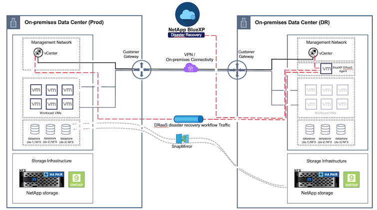

NetApp Disaster Recovery for NFS Datastores
Implementing disaster recovery through block-level replication from the production site to the disaster recovery site is a resilient and cost-effective method for safeguarding workloads against site outages and data corruption events, such as ransomware attacks. Using NetApp SnapMirror replication, VMware workloads running on on-premises ONTAP systems with NFS datastore can be replicated to another ONTAP storage system located in a designated recovery datacenter where VMware is also deployed.
This section of the document describes the configuration of NetApp Disaster Recovery to set up disaster recovery for on-premises VMware VMs to another designated site. As part of this setup, Console agent, onboarding the ONTAP arrays, Defining Sites and associating VMware vCenter. In addition, this document details how to configure replication between sites and how to setup and test a recovery plan. The last section has instructions for performing a full site failover and how to failback when the primary site is recovered and bought online.
Utilizing the Disaster Recovery, part of NetApp Data Services, companies can easily discover their on-premises VMware vCenters and ONTAP storage. Organizations can then create resource groups, create a disaster recovery plan, associate it with resource groups, and test or execute failover and failback. SnapMirror provides storage-level block replication to keep the two sites up to date with incremental changes, resulting in a Recovery Point Objective (RPO) of up to 5 minutes. Additionally, it is possible to simulate disaster recovery procedures without affecting production or incurring additional storage costs.
Disaster Recovery leverages ONTAP's FlexClone technology to create a space-efficient copy of the NFS datastore from the last replicated Snapshot on the disaster recovery site. After completing the disaster recovery test, customers can easily delete the test environment without impacting actual replicated production resources. In case of an actual failover, the Disaster Recovery orchestrates all the necessary steps to automatically bring up the protected virtual machines on the designated disaster recovery site with just a few clicks. The service will also reverse the SnapMirror relationship to the primary site and replicate any changes from the secondary to the primary for a failback operation, when needed. All these capabilities come at a fraction of the cost compared to other well-known alternatives.

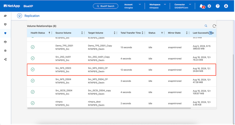

Configuring Storage replication between source site array and destination site array
SnapMirror provides data replication in a NetApp environment. Built on NetApp Snapshot technology, SnapMirror replication is extremely efficient because it replicates only the blocks that have been changed or added since the previous update. SnapMirror is easily configured by using either NetApp OnCommand System Manager or the ONTAP CLI. NetApp Data Services also creates the SnapMirror relationship provided cluster and SVM peering is configured beforehand.
For cases in which the primary storage is not completely lost, SnapMirror provides an efficient means of resynchronizing the primary and DR sites. SnapMirror can resynchronize the two sites, transferring only changed or new data back to the primary site from the DR site by simply reversing the SnapMirror relationships. This means replication plans in Disaster Recovery can be resynchronized in either direction after a failover without recopying the entire volume. If a relationship is resynchronized in the reverse direction, only new data that was written since the last successful synchronization of the Snapshot copy is sent back to the destination.
Note If SnapMirror relationship is already configured for the volume via CLI or System Manager, NetApp Data Services picks up the relationship and continues with the rest of the workflow operations.
How to set it up for VMware Disaster Recovery
The process to create SnapMirror replication remains the same for any given application. The process can be manual or automated. The easiest way is to leverage NetApp Console to configure SnapMirror replication by using simple drag & drop of the source ONTAP system in the environment onto the destination to trigger the wizard that guides through the rest of the process.
Figure showing input/output dialog or representing written content
Disaster Recovery can also automate the same provided the following two criteria's are met:
  • Source and destination clusters have a peer relationship.
  • Source SVM and destination SVM have a peer relationship.
Note If SnapMirror relationship is already configured for the volume via CLI, Disaster Recovery picks up the relationship and continues with the rest of the workflow operations.

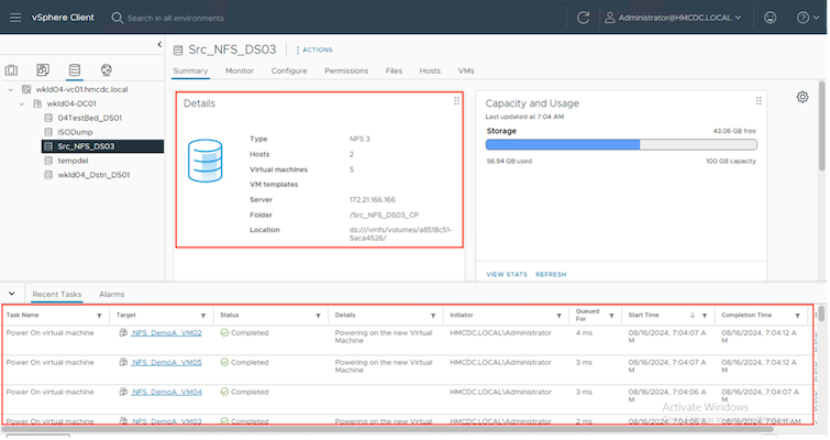

When the VMware administrator runs a test failover operation, Disaster Recovery automates the following tasks:
  • Triggering SnapMirror relationships to update storage at the destination site with any recent changes that were made at the production site.
  • Creating NetApp FlexClone volumes of the FlexVol volumes on the DR storage array.
  • Connecting the NFS datastores in the FlexClone volumes to the ESXi hosts at the DR site.
  • Connecting the VM network adapters to the test network specified during the mapping.
  • Reconfiguring the VM guest operating system network settings as defined for the network at the DR site.
  • Executing any custom commands that have been stored in the replication plan.
  • Powering on the VMs in the order that is defined in the replication plan.

When the VMware administrator performs a failover operation, Disaster Recovery automates the following tasks:
  • Break and fail over the NetApp SnapMirror relationships.
  • Connect the replicated NFS datastores to the ESXi hosts at the DR site.
  • Connect the VM network adapters to the appropriate destination site network.
  • Reconfigure the VM guest operating system network settings as defined for the network at the destination site.
  • Execute any custom commands (if any) that have been stored in the replication plan.
  • Power on the VMs in the order that was defined in the replication plan.

From Console or the ONTAP CLI, you can monitor the replication health status for the appropriate datastore volumes, and the status of a failover or test failover can be tracked via Job Monitoring.
Note If a job is currently in progress or queued, and you wish to stop it, there is an option to cancel it.
