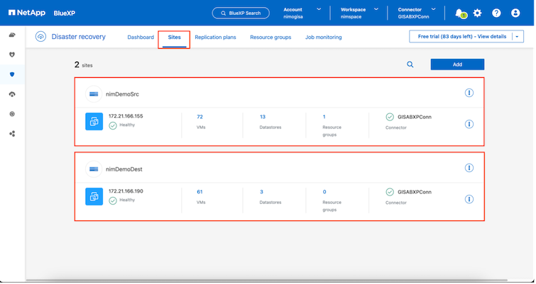

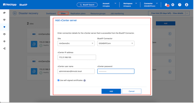

The first step in preparing for disaster recovery is to discover and add the on-premises vCenter and storage resources to Disaster Recovery.
Note Ensure the ONTAP storage systems are added to the working environment within the canvas.
Open Console and select Protection > Disaster Recovery from left navigation. Select Discover vCenter servers or use top menu, Select Sites > Add > Add vCenter.
Figure showing input/output dialog or representing written content
Add the following platforms:
  • Source. On-premises vCenter.
  • Destination. VMC SDDC vCenter.
Once the vCenters are added, automated discovery is triggered.

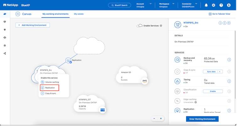

SnapMirror makes use of ONTAP snapshots to manage the transfer of data from one location to another. Initially, a full copy based on a snapshot of the source volume is copied over to the destination to perform a baseline synchronization. As data changes occur at the source, a new snapshot is created and compared to the baseline snapshot. The blocks found to have changed are then replicated to the destination, with the newer snapshot becoming the current baseline, or newest common snapshot. This enables the process to be repeated and incremental updates to be sent to the destination.
When a SnapMirror relationship has been established, the destination volume is in an online read-only state, and so is still accessible. SnapMirror works with physical blocks of storage, rather than at a file or other logical level. This means that the destination volume is an identical replica of the source, including snapshots, volume settings, etc. If ONTAP space efficiency features, such as data compression and data deduplication, are being used by the source volume, the replicated volume will retain these optimizations.
Breaking the SnapMirror relationship makes the destination volume writable and would typically be used to perform a failover when SnapMirror is being used to synchronize data to a DR environment. SnapMirror is sophisticated enough to allow the data changed at the failover site to be efficiently resynchronized back to the primary system, should it later come back online, and then allow for the original SnapMirror
relationship to be re-established.
How to set it up for VMware Disaster Recovery
The process to create SnapMirror replication remains the same for any given application. The process can be manual or automated. The easiest way is to leverage Console to configure SnapMirror replication by using simple drag & drop of the source ONTAP system in the environment onto the destination to trigger the wizard that guides through the rest of the process.

NetApp Data Services can also automate the same provided the following two criteria's are met:
  • Source and destination clusters have a peer relationship.
  • Source SVM and destination SVM have a peer relationship.
Note If SnapMirror relationship is already configured for the volume via CLI, Console picks up the relationship and continues with the rest of the workflow operations.
Note Apart from the above approaches, SnapMirror replication can also be created via ONTAP CLI or System Manager. Irrespective of the approach used to synchronize the data using SnapMirror, Disaster Recovery orchestrates the workflow for seamless and efficient disaster recovery operations.

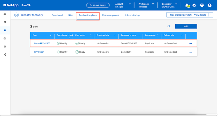

Once the resource groups are created, the next step is to create the execution blueprint or a plan to recover virtual machines and applications in the event of a disaster. As mentioned in the prerequisites, SnapMirror replication can be configured beforehand or DRaaS can configure it using the RPO and retention count specified during creation of the replication plan.

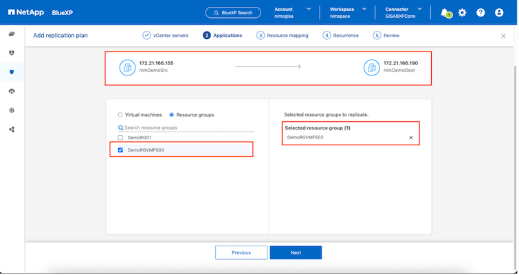

Configure the replication plan by selecting the source and destination vCenter platforms from the drop down and pick the resource groups to be included in the plan, along with the grouping of how applications should be restored and powered on and mapping of clusters and networks. To define the recovery plan, navigate to the Replication Plan tab and click Add Plan.
First, select the source vCenter and then select the destination vCenter.
The next step is to select existing resource groups. If no resource groups created, then the wizard helps to group the required virtual machines (basically create functional resource groups) based on the recovery objectives. This also helps define the operation sequence of how application virtual machines should be restored.

Select the recurrence type. In simple words, select Migrate (one time migration using failover) or recurring continuous replication option. In this walkthrough, Replicate option is selected.
Once done, review the created mappings and then click on Add plan.

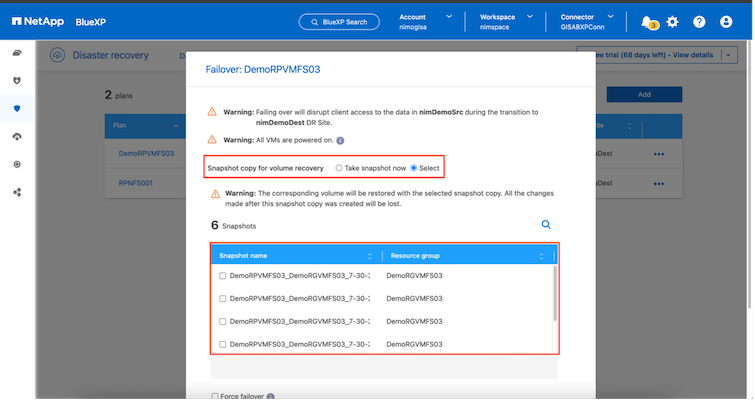

Once the replication plan is created, failover can be performed depending on the requirements by selecting the failover option, test-failover option, or the migrate option. Disaster Recovery ensures that the replication process is being executed according to the plan every 30 minutes. During the failover and test-failover options, you can use the most recent SnapMirror Snapshot copy, or you can select a specific Snapshot copy from a point-in-time Snapshot copy (per the retention policy of SnapMirror). The point-in-time option can be very helpful if there is a corruption event like ransomware, where the most recent replicas are already compromised or encrypted. Disaster Recovery shows all available recovery points.
To trigger failover or test failover with the configuration specified in the replication plan, click on Failover or Test failover.
What happens during a failover or test failover operation?
During a test failover operation, Disaster Recovery creates a FlexClone volume on the destination ONTAP storage system using the latest Snapshot copy or a selected snapshot of the destination volume.

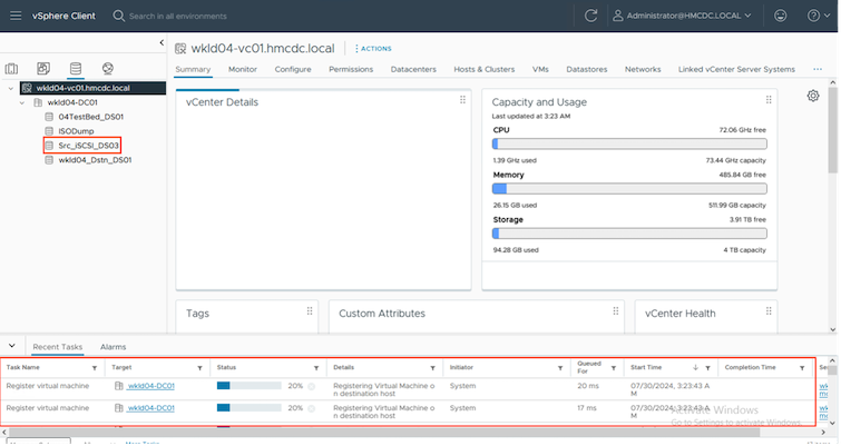

In the event of real disaster event occurs, Disaster Recovery performs the following steps:
  1. Breaks the SnapMirror relationship between the sites.
  2. Mounts the VMFS datastore volume after resignature for immediate use.
  3. Register the VMs
  4. Power on VMs

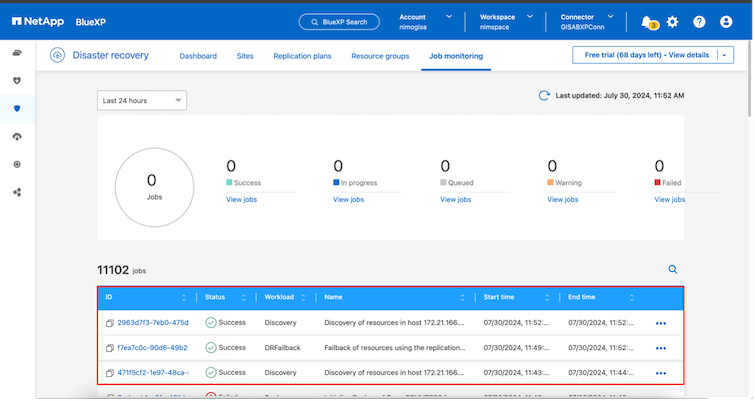

From Console or the ONTAP CLI, you can monitor the replication health status for the appropriate datastore volumes, and the status of a failover or test failover can be tracked via Job Monitoring.
This provides a powerful solution to handle a tailored and customized disaster recovery plan. Failover can be done as planned failover or failover with a click of a button when disaster occurs and decision is made to activate the DR site.
